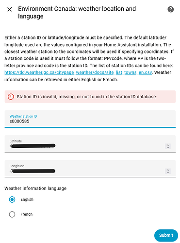

I just wanted to report as of today/yesterday, it seems like it stopped working again. I tried to remove the integration and re-add it but keep getting this error. Clear browser cache and all.

No luck. The same error shows up… Last time it was able to automatically select the closest station.
According to the screenshot you posted, the Weather Station ID field expects a two-letter provincial abbreviation followed by the station ID.
For example:
ON/s0000585
However, I tried it, as well as a station ID in another province, and it failed to work. It suggests something has changed on Environment Canada’s side and now the integration’s configurator is no longer able to correctly validate the station ID.
