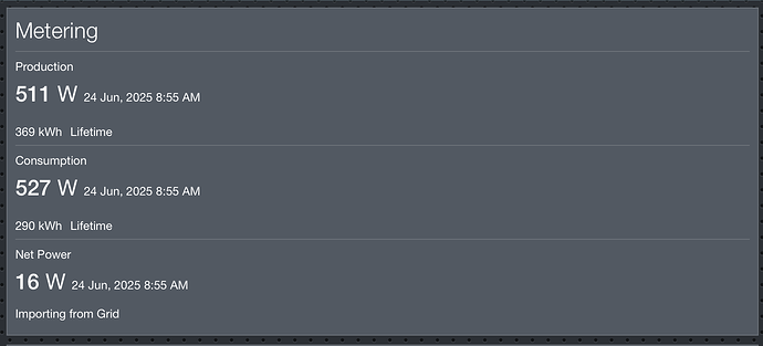

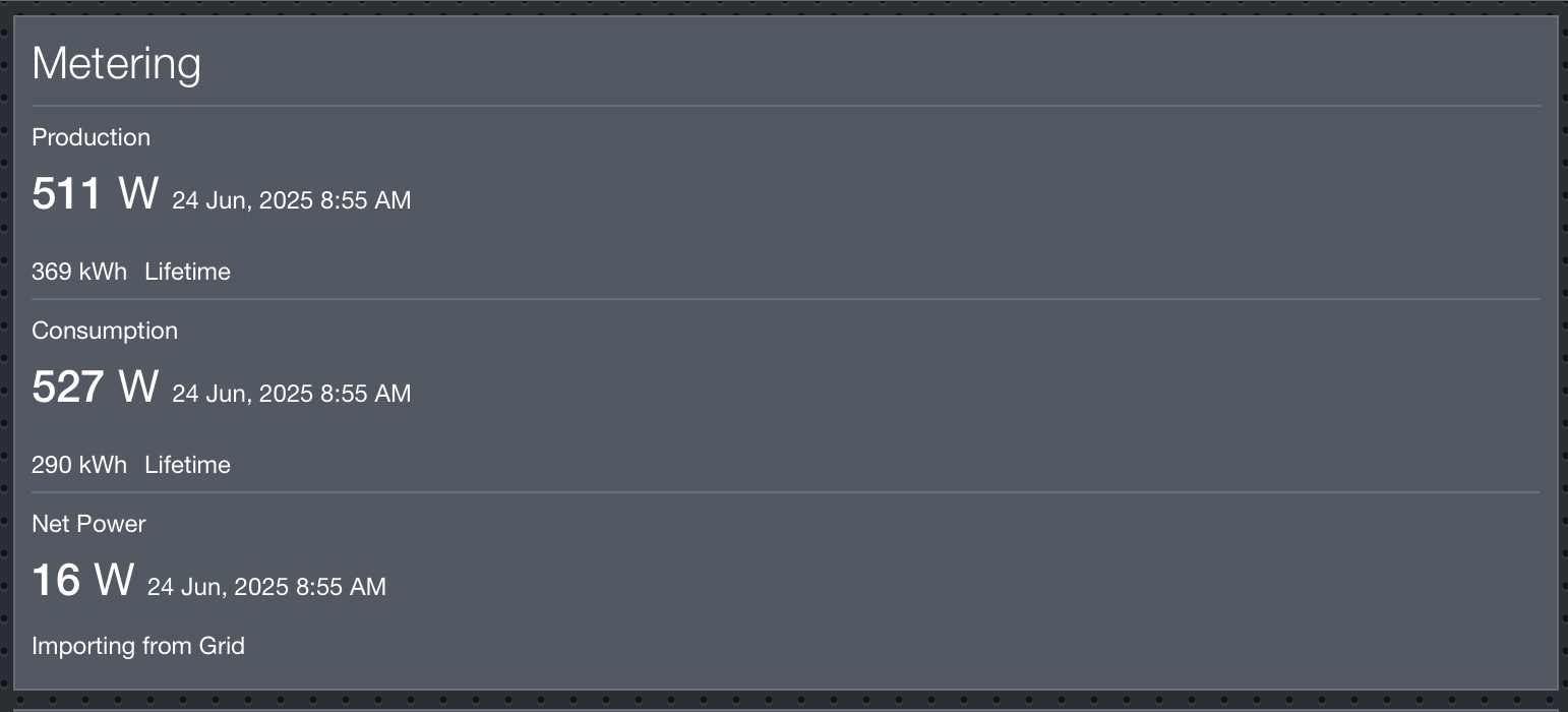

Anybody with an Enphase Envoy-S Metered able to confirm something relating to storage CTs?
Recently had an Enphase solar & battery installed, and while there’s a storage/battery CT installed it’s not showing up in the Enphase integration. Checking the local Envoy UI it shows Production and Consumption metering (I have both P & C CTs), but nothing for storage. I suspect there’s a misconfiguration by the installer (we’ve had other issues), but don’t know what a “correct” setup looks like.
If there’s someone out there with Envoy-S Metered and has a storage/battery CT installed, can you tell me whether you see the CT in the local Envoy UI?
Currently on firmware D8.3.5058 (348522).
Thanks.

Hi. So I’ve checked with both the diagnostic file, and doing a quick python script to directly query the Envoy, and both return
      "ct_count": 2,
      "ct_consumption_meter": "net-consumption",
      "ct_production_meter": "production",
      "ct_storage_meter": null
so I’m fairly sure the Envoy isn’t reporting the CT, but it was more a question of whether (if one’s installed) the Storage CT shows up in the Envoy Web UI, or it’s always just Production/Consumption/Net?
For some reason it’s being a bit of a battle to get Enphase to recognise that the CT isn’t working, so if it should show up in that “Metering” section that would be a fairly big flag I would wave at them to show it’s not working… :slight_smile:
