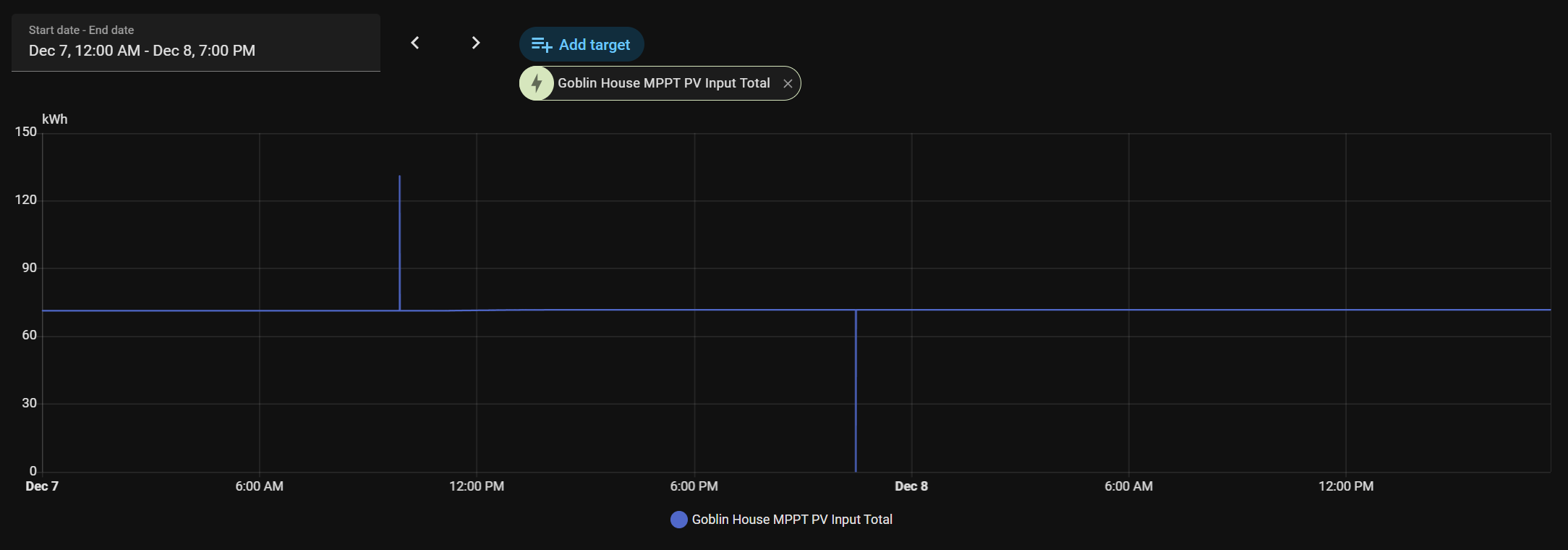

I have an ESPHome device talking RS485 to my Epever upower-hi 3KW unit. Looking at the solar “total” values, I’m seeing a (usually every few days) error where the statistics briefly blip to 0 or otherwise to an extremely high value (megawatts, on a 1KW array) - I suspect there’s bit-shift error on the reading, and sometimes the value doubles. No idea why the value reads as zero more frequently. Aside from replacing the (terrible, un-twisted, flat, and probably super noise-prone,) cable I currently have wired up to my ESP, are there filters I can apply to avoid reporting those “blips”?
Example from the Statistics for today. This was set up as a “total_increasing” sensor type up until today, and I’m changing it to “total” going forward to see if that helps with my energy dashboard not showing super crazy results. I’d still like to filter the zero and something-like-double readings I’m getting on occasion.

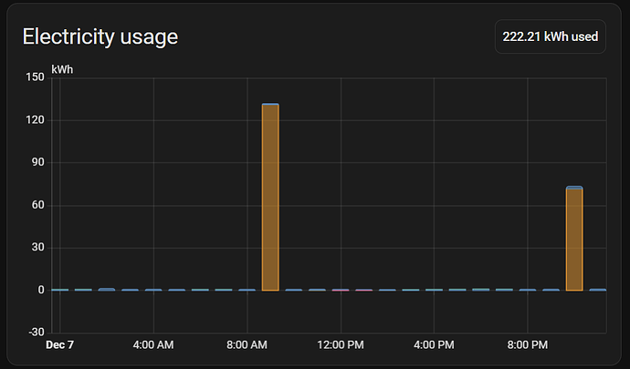

Main reason it’s a problem for me is the “energy” dashboard:
