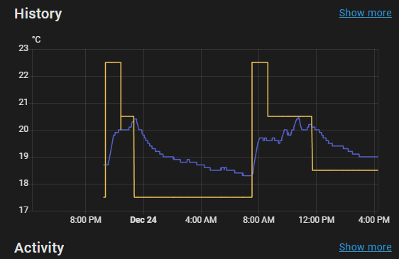

For me I track things like this:

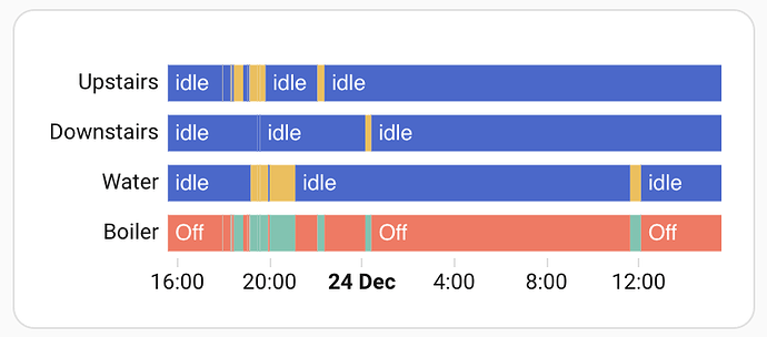

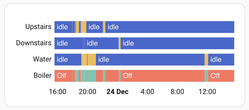

Can you explain how you did the timeline chart of idle/on etc?

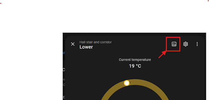

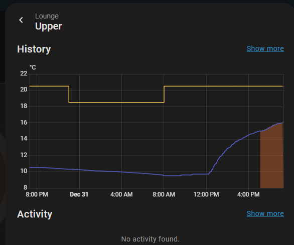

Glad to see others taking advantage of this integration. I get the chart from

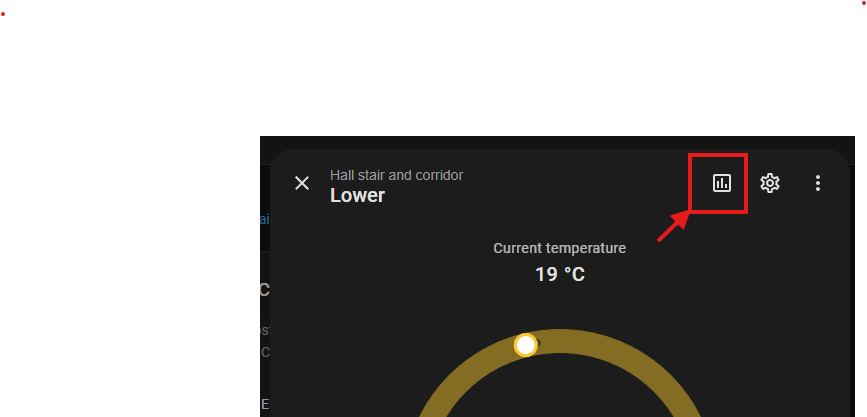

Devices & Integrations>Devices>EPH Controls Ember> Thermostat >Controls, then click on the icon in the upper right corner:-
Thanks, I was able to get that one, it’s the 3 horizontal bar one, that lists boiler, upstairs downstairs that I’m most interested in.
You need sensors to track boiler state.
In settings->devices->helpers you can create them
boilerdownstairs is a template with options:
{{ state_attr('climate.downstairs','hvac_action') }}
Upstairs and water are similar
boiler is a template and uses:
{% if is_state_attr('climate.hot_water', 'hvac_action', 'heating') or is_state_attr('climate.downstairs', 'hvac_action', 'heating') or is_state_attr('climate.upstairs', 'hvac_action', 'heating')  %}
            on
      {% else %}
            off
      {% endif %}
boilerdaily is a history stats helper tracking boiler and needs:
Start:
{{ today_at() if now() < today_at("23:59") else now() }}
End:
{{ now() }}
The graph to show boiler state:
  - type: history-graph
    entities:
      - entity: sensor.boilerupstairs
      - entity: sensor.boilerdownstairs
      - entity: sensor.boilerwater

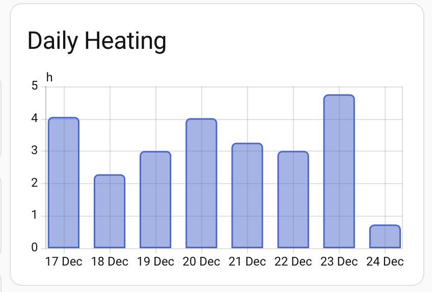

The graph to show daily usage
chart_type: bar
period: day
type: statistics-graph
entities:
  - sensor.boiler_daily
stat_types:
  - max
hide_legend: true
days_to_show: 7
title: Daily Heating

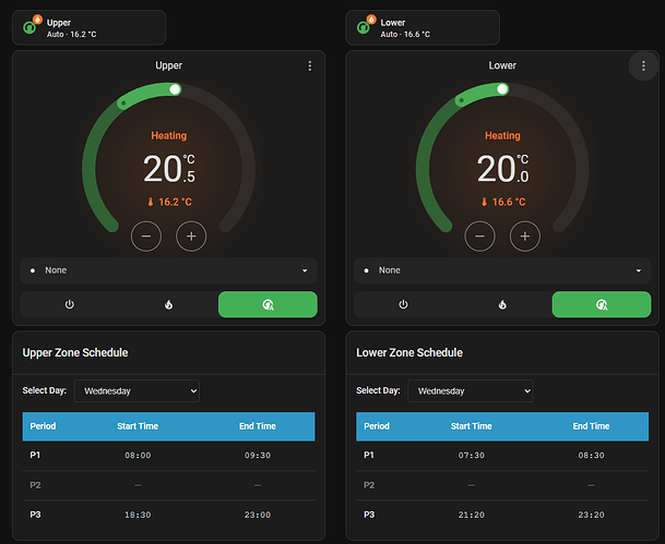

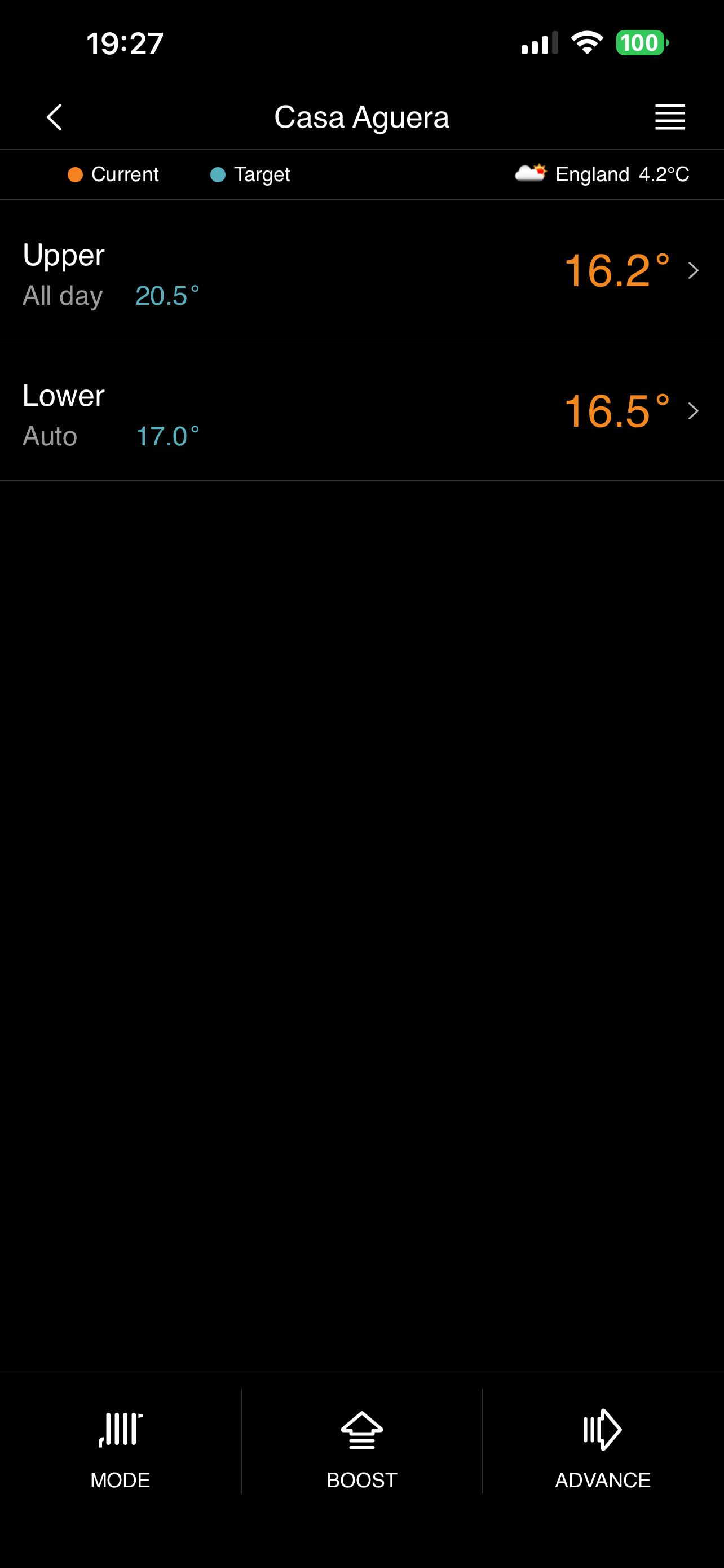

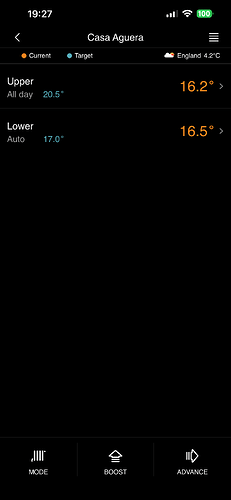

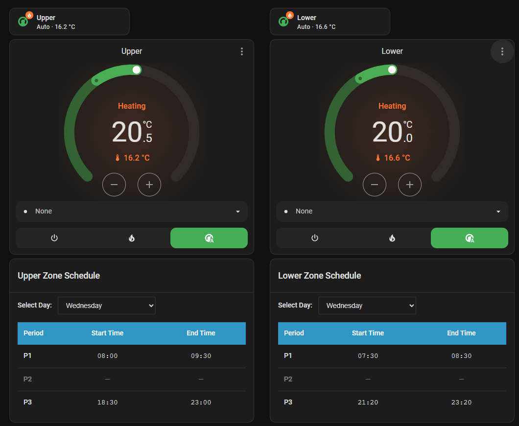

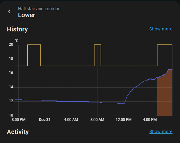

We have been away for a few days and just back so only been able to do a little investigation on the new updates. The system was set to holiday mode on the Ember App and set to come on at 12 today. I can see from the temp chart that heating kicked in and working towards the expected target temp of 20.5 on the upper zone. This is on Mode All Day.
However the lower zone (Mode Auto), the target temperature as reported by the Ember App is 17 degrees. as it is on a setback (of 3 degrees), but in HA the control is reporting the target as 20 degrees. This jump seems to have occurred when I updated to version 3.5. I suspect the logic might for this controller has a bug.
When the heating has reached target and/or turned off I will post more insights.
This is how the Ember App is currently reporting:-
and in HA:-
I hope this helps
