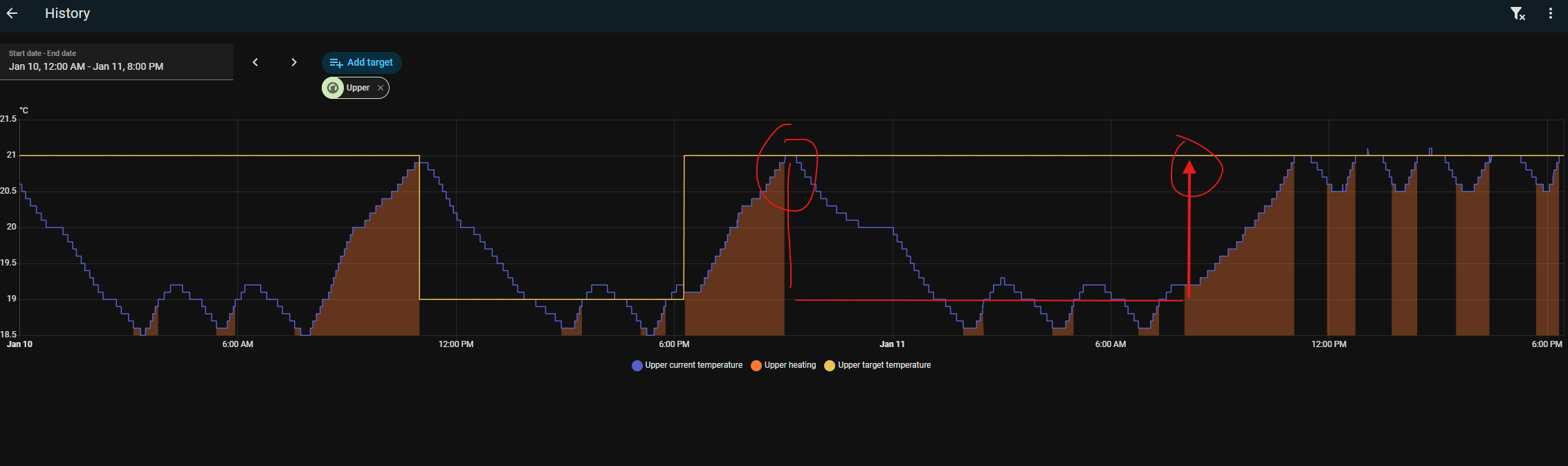

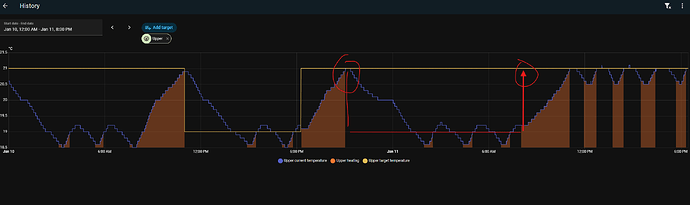

You can see on Saturday, 10th Jan we had the mode set to ‘All Day’, that should mean from 8 am (P1 on) to p3 off (9pm) the target should be 21 degrees. However from midnight to 8am the target should drop to 19 degrees which is missing. However at 11am we left home and changed the mode to Auto at which point the target correctly drops to 19 degrees, As we returned at 6.16 we reactivated the ‘All Day’, mode and the target returns to 21 degrees which is correct. However at 9pm P3 off, should reset the target to 19 degrees but as you can see the target does not change.
I think the issue is handling the target temperatures when the mode is set to ‘All day’.

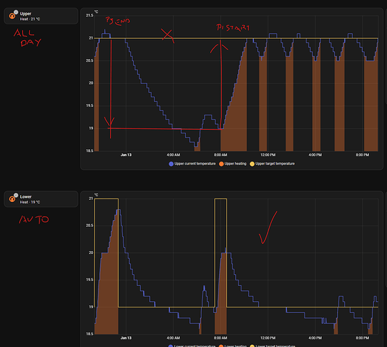

What I can confirm from the data being reported by the two thermostats
Mode - Auto
Current temperature, correctly follows the temperature reported by the thermostat.
Heating, correctly follows when the thermostat calls for heat.
Target temperature correctly follows the schedule.
Mode - All Day
Heating correctly follows when the thermostat calls for heat.
Target temperature does not follow the logic which is that the target temperature is reduced by the setback assigned to the thermostat from the end of P3 end to the beginning of P1 start
The following shows an example of charts from thermostats, one using the ALL DAY
mode, which shows the issue. the other shows the output for the AUTO mode which reports correctly.
If that could be addressed, that would be fantastic.
