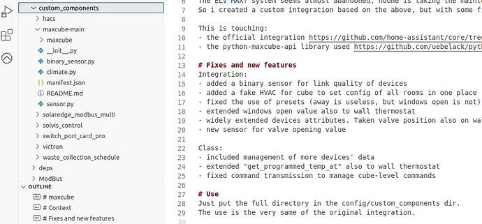

Unfortunately, I can’t currently find a way to read the valve position. I found a custom integration on GitHub (https://github.com/MassiPi/maxcube) and manually copied it into the custom_components directory.

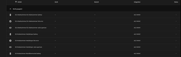

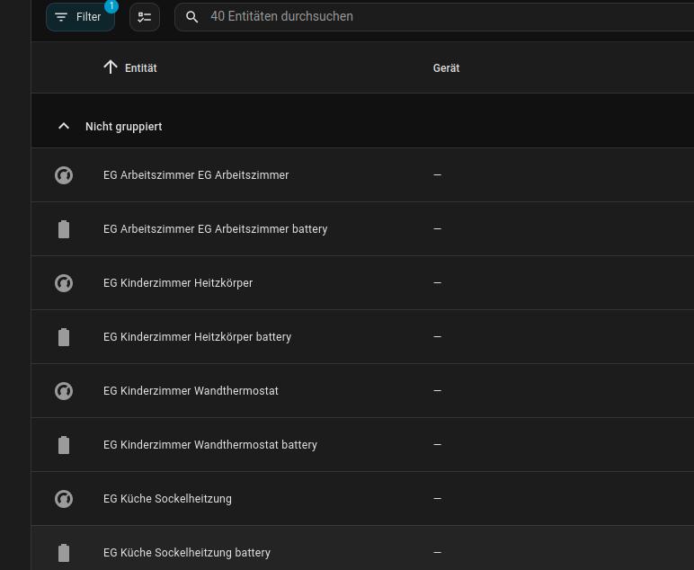

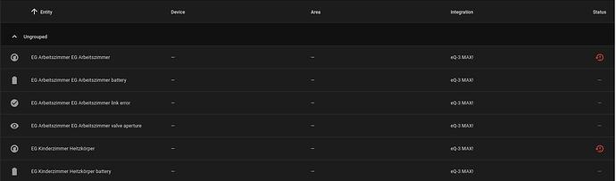

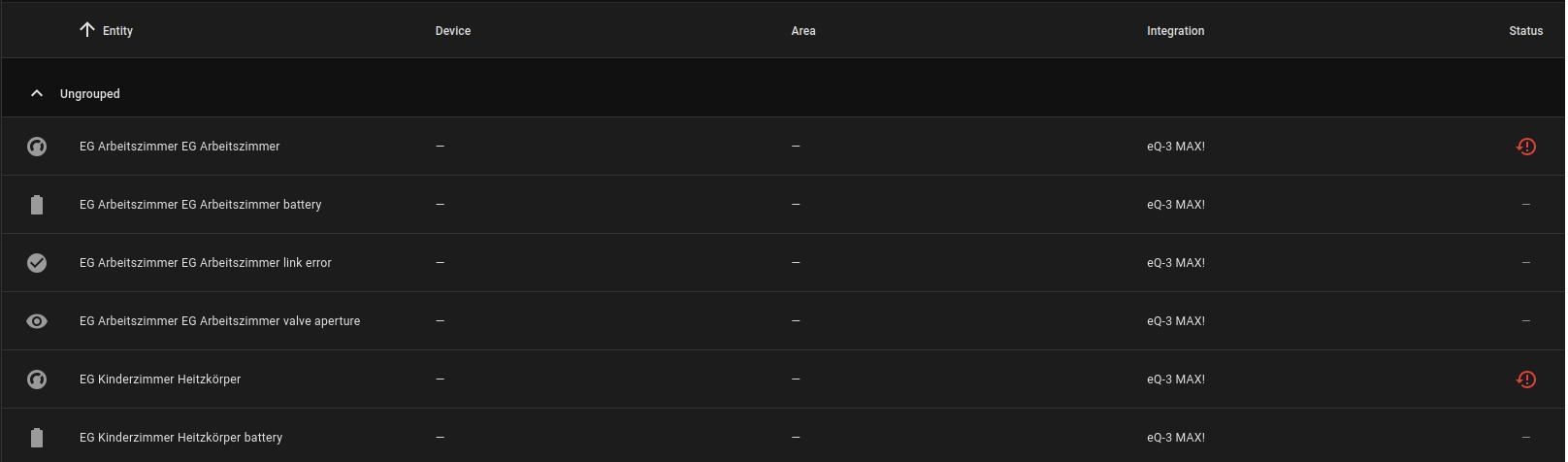

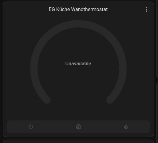

Good Morning,
something happened but i don’t know why.

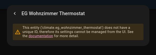

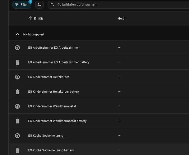

First i get new “entities” > “link error” and “valve aperture” but the basic entiti does not word anymore (show now temprature and it was not possible to set Temprature") in the dashbord they was markt as not avalible.
So (i think this was a mistake) i removed this because it was a fail of two entries from the same thing in the Core-Interation and the Costom-integration. So i hope they will be refound by reboot. But this does not hapend. So i have no idea how i can fix this.
If the custom extention working i lost the basics, i can recreate this by removing the extention. Then i get the basic but lost Link error and valve aperture.
Battery works still in both
