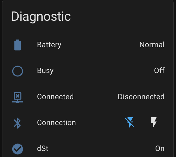

One thing you could do to check how many open connections are held is to enable the debug entities (click configure and tick the debug entities checkbox on each device here: http://homeassistant.local:8123/config/integrations/integration/dbuezas_eq3btsmart)
Then you can open each of the devices (scroll down) and see how many of them show as connected
