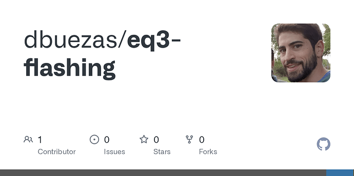

I managed to modify the BLE firmware to remove pairing completely! not even like the old versions, just no pairing at all
Also managed to flash the ones i had bricked via uart. Hopefully nobody will need to do this since the auth removal now works reliably, but i’ll add it again.
I didn’t find any way to get the MCU to spit the measured room temperature though.
There, full guide on how to completely remove pairing from the firmware, even on the very last version!

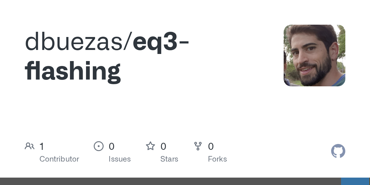

If pairing is what is misbehaving, you may try to flash the noauth firmware for the ble chip (quick-start in GitHub - dbuezas/eq3-flashing · GitHub). Removing pairing makes it work a lot better for me (I have multiple bluetooth usb dongles)
