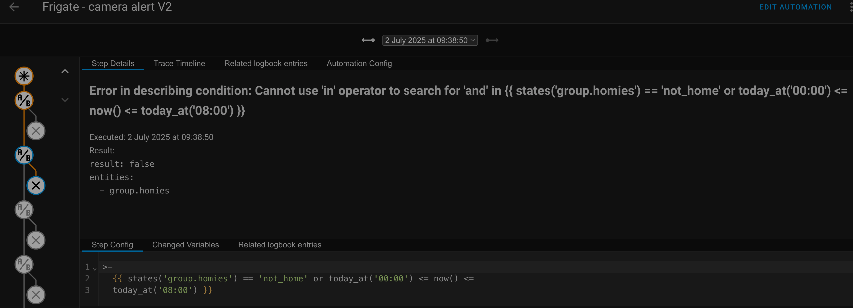

I’m a bit puzzled by an automation that used to work so far I recall and is now spitting out weird error messages. It’s a fairly straightforward one, creating a snapshot of cameras and notifying if cameras are catching something important at night or when we’re not home.
The point of those two condition tests is to 1/ debounce the execution of this automation (if executed less than 60s ago, don’t fire again) and 2/ check if we are home or if it’s during night.
The full error messages, as seen in automation traces, are:
“Error in describing condition: Cannot use ‘in’ operator to search for ‘and’ in {{ (as_timestamp(now()) - as_timestamp( state_attr(‘automation.frigate_camera_alert_v2_2’, ‘last_triggered’), 0)) | int > 60 }}”
And I get instantly below a second one:
“Error in describing condition: Cannot use ‘in’ operator to search for ‘and’ in {{ states(‘group.homies’) == ‘not_home’ or today_at(‘00:00’) <= now() <= today_at(‘08:00’) }}”
I’m not really sure why this error message is showing up since I’m not doing any kind of IN lookup, like is “bla” contained in “blablabla”. It’s a pure simple template evaluation.

The weirdest part is that the automation execution seems to survive the 1st error message and proceed to the second test anyway…!?
Does someone have any idea?

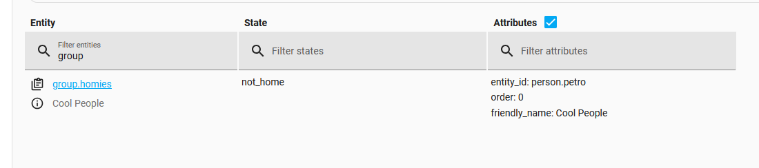

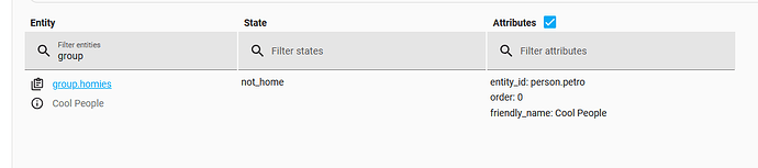

It seems the behavior of a group of trackers (home/not_home) is somewhat different from what it used to be in previous versions. And when I test in the automation editor, the state of a person and the state of a group, the test of a person offers home/not_home. Still, the test of a group of person trackers visually shows this instead (unknown/unavailable):

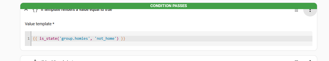

But if I test it in the developer tab in a template with:
{{ is_state('group.homies', 'not_home') }}
It renders correctly ‘true’ or ‘false’.
@123 @petro any clue? I know this type of group is the “Old style group” as per the documentation, but it’s still supposed to work in manual Yaml automation. Anyway “new” groups don’t seem to handle device trackers do they?

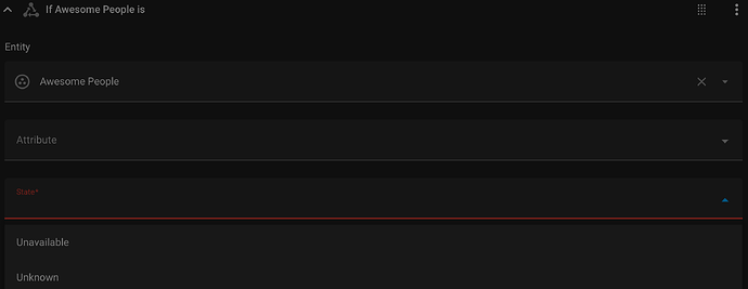

Old school groups haven’t changed in years. They have been made legacy, which means no code changes.
Old school groups have never offered state options in the dropdown list either. So you’re miss remembering that. You have to manually type out home or not_home.

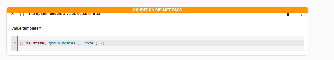

ok is it just a visual bug in the automation tracer or is the automation really failing?
Well, I just created your test and both are working for me. So I must be remembering that templates with trigger variables don’t work when testing.
Ah, showing the trace, I see why it’s not working for you. You have exterior quotes on your template. Those should only exist in yaml, when you use the fromend, it should look like what I had above.

So I should remove the double quotes from my templated test conditions?

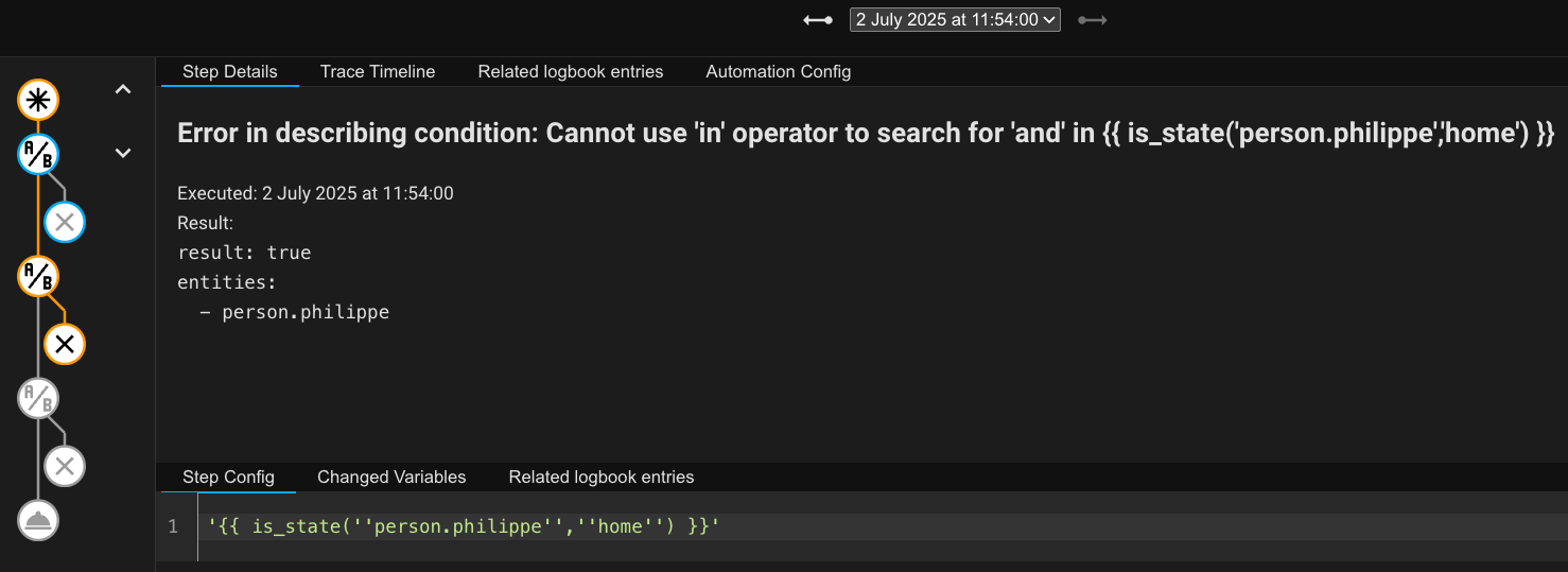

It seems the problem is with shorthand conditions. When you switch back to visual editor, it should add all the additional plumbing.
Ok… As usual, you’re 100% right @petro.
I did more tests. It’s just a visual glitch with shorthand conditions, indeed, but the automation still proceeds, which is tricky because, in some cases, this message relates to a real error.
This form gives a visual error in the automation tracer, to all conditions even if only one seems to be triggering this (the tracker group test), but the automation still proceeds:
    conditions:
      - "{{ is_state('group.homies','home') }}"
The form generated by the automation UI, which doesn’t use the short form but instead the full form triggers no visual error.:
  - condition: template
    value_template: '{{ is_state(''group.homies'',''home'') }}'

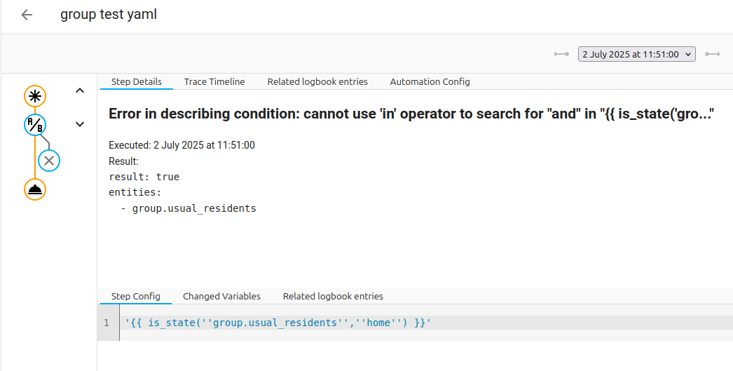

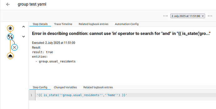

Yes, looks like a bug with shorthand conditions in the UI trace view. I recreated the test automation in YAML (as I usually do):
- alias: group test yaml
  description: ""
  triggers:
    - trigger: time_pattern
      minutes: /1
  conditions:
    - "{{ is_state('group.usual_residents','home') }}"
  actions:
    - action: system_log.write
        logger: TEST
        level: warning
        message: TESTING Group homies test {{ states('group.usual_residents') }}
and now see the error on the trace:
No error is generated in the logs and the automation works fine. This is not in a package, just standard config.
I see the same error message in all my existing automations that use shorthand template conditions.
Issue raised: Error message in automation traces with YAML template shorthand conditions · Issue #26031 · home-assistant/frontend · GitHub
