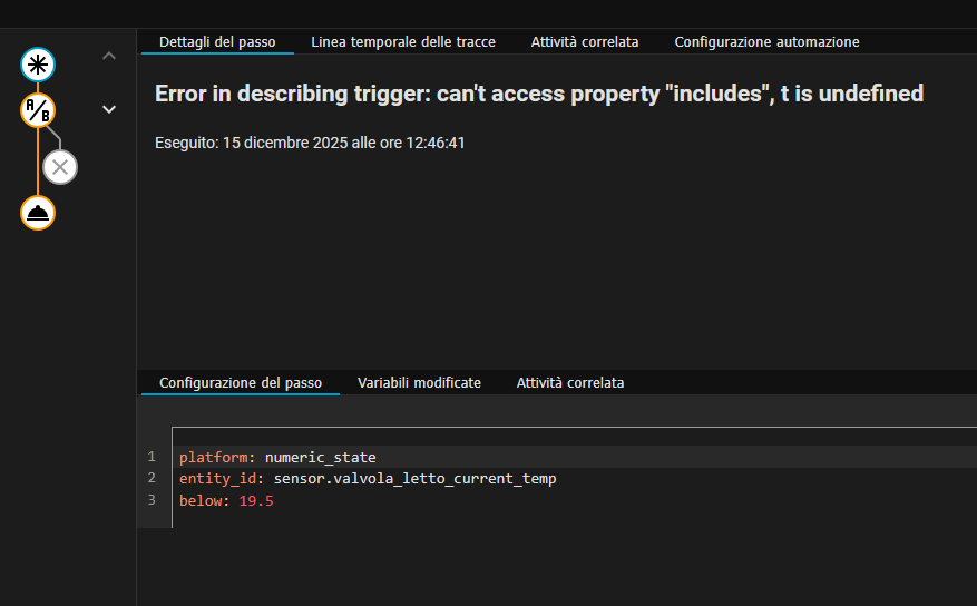

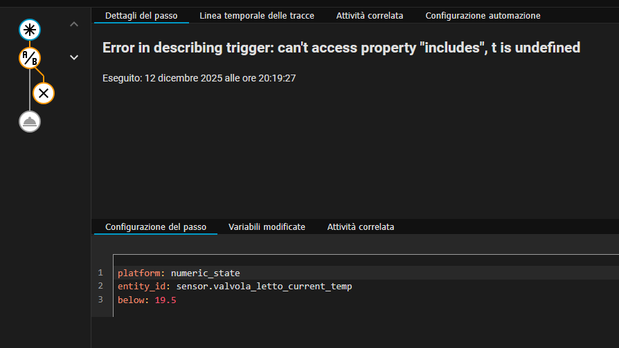

Error in describing trigger: can't access property "includes", t is undefined
Hi, I’m getting the error in the title that I can’t resolve. This is the trigger

The trigger is obviously that of an automation
alias: Termosifoni - Controllo automatico new
description: Procede con l'accensione automatica del termosifone quando la temperatura va sotto i 19.5 gradi
trigger:
  - platform: numeric_state
    entity_id: sensor.valvola_letto_current_temp
    below: 19.5

You’re right, sorry. The error appears when I view the automation trace to verify its functionality. Here’s a screenshot of the error:

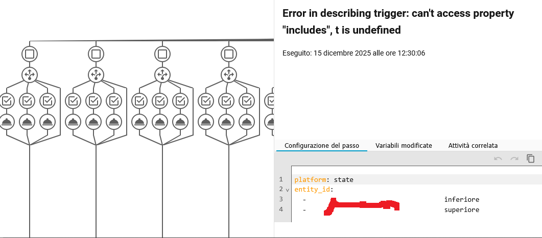

Same Here:
The trigger portion shown does not appear to be incorrect to me and the automation is still being executed.
The error is just something in the GUI, it normally describes the trigger there, but it can’t as you are using the legacy trigger syntax using platform instead of trigger.
If you change your trigger to:
  - trigger: numeric_state
    below: 19.5
it will show a description of the trigger, and no longer this error message.
Your automation will run fine though.

@TheFes The format you suggested seems to be incorrect.
It surely is :slight_smile:
triggers: # trigger > triggers
  - trigger: numeric_state # platform > trigger
    below: 19.5
conditions: # condition > conditions
  - not: # a list is expected here
      - condition: state
        entity_id: climate.termostato
        attribute: hvac_action
        state: 'heating'
actions: # action > actions
  - service: climate.set_temperature
    entity_id: climate.valvola_letto
      temperature: 19.5
This would be your automation following the latest automation syntax
Okay, it works now. Thanks.
But does this mean we have to change all the triggers for our automations?
The automations work. There’s only an error in displaying the description for the trigger. If that bothers you, you’ll need to change platform to trigger
