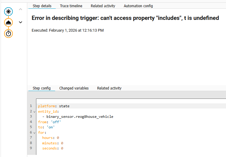

Error in describing trigger: can't access property "includes", t is undefined

Just change platform to trigger and that error while viewing the trace will be gone. I doubt it will solve your time drift issue though.
Thank you and I took your advice and changed all the automations. You could be right, may have nothing to do with it. At this point I’m struggling to determine the cause as it seems others are too.
Unfortunately this isn’t a time drift issue, at least not in anyway I can determine. HA shows the correct time, the events are simply fired late or not at all. I’ll come back in a few days if it does solve the problem.
I fixed another automation with the same error.

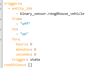

The issue for my automations was the “platform” to “trigger” change. Some variant: of:
  1. Noticing the error message.
  2. Checking the “Step Config”
Followed by “Edit in YAML” and seeing that “platform” has been converted to “trigger”
… and manually stepping through all of my automations, and SAVE as @Chopper_Rob noted.

it’s the same thing. Under the hood, the word platform is converted to triggers. There’s no built in system in HA that will warn you for using platform, so you must be using some 3rd party text software like VSCode that’s just making things up.

If platform is used, the GUI is unable to describe the trigger (as shown in the screenshot). The automation will run fine, but it will show the error from the screenshot instead of description of the trigger (like When House Vehicle changes from running to not running).
This is probably a bug which could be solved in the frontend, but right now it is also solved by changing platform to trigger. Then the GUI can describe the trigger.
