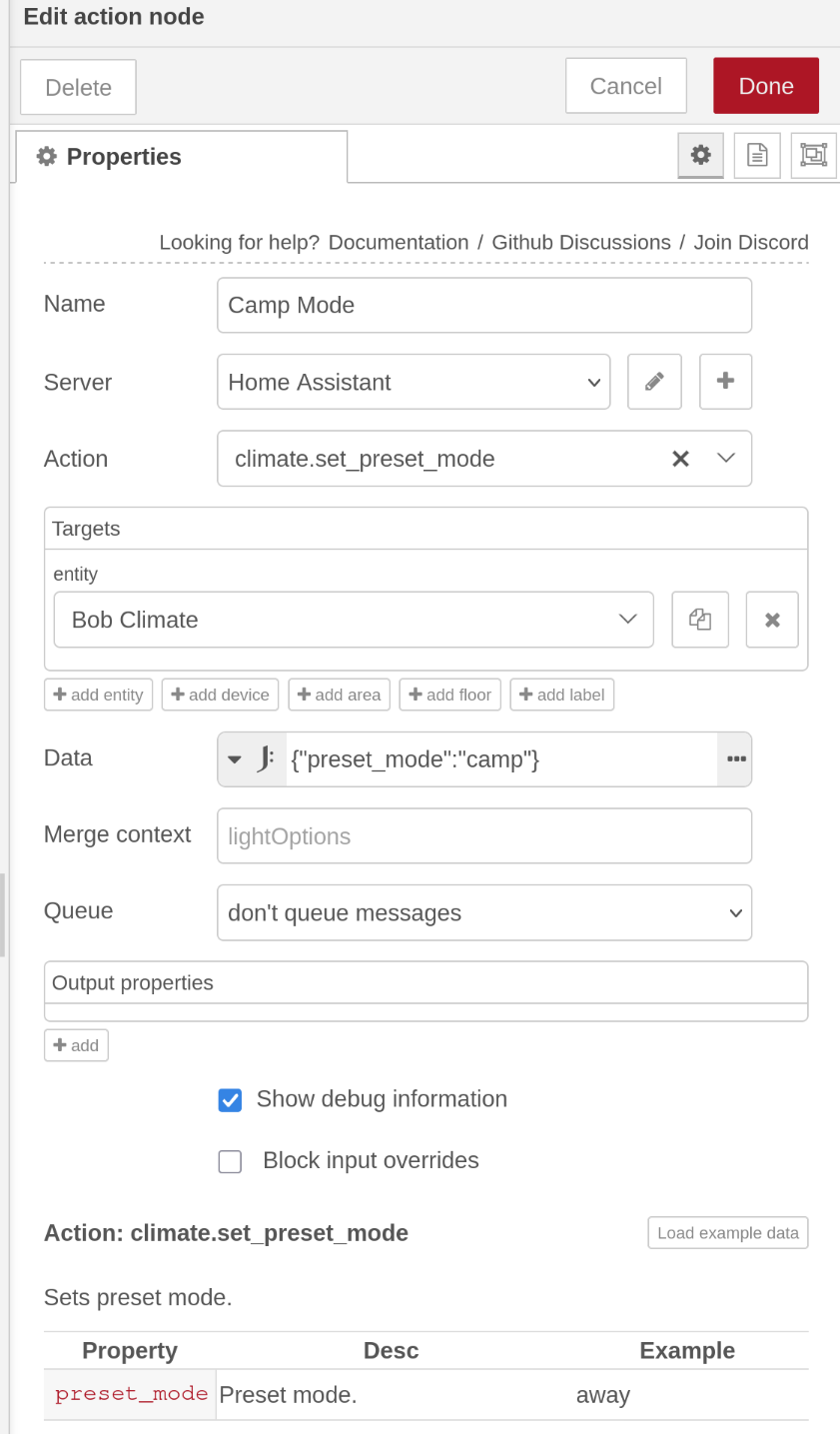

When I try to set the Climate Preset Mode in Node Red on my Tesla I get this error:
“HomeAssistantError: Command failed, cpd_enabled”
I cant find anyhing when I google that error
I use “climate.set_preset_mode”
And then send this: “{“preset_mode”:“camp”}”
Any help

“Bob climate” is the climate entity for my car. And yes my car is named bob :grin:
