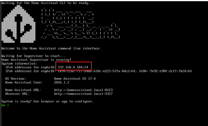

Open the console on the virtual machine. Do you have an IP address listed?
You’ll want to change from NAT to bridged mode, but not sure that is causing your issue at the moment but will be a blocker to other things so worth doing now.
