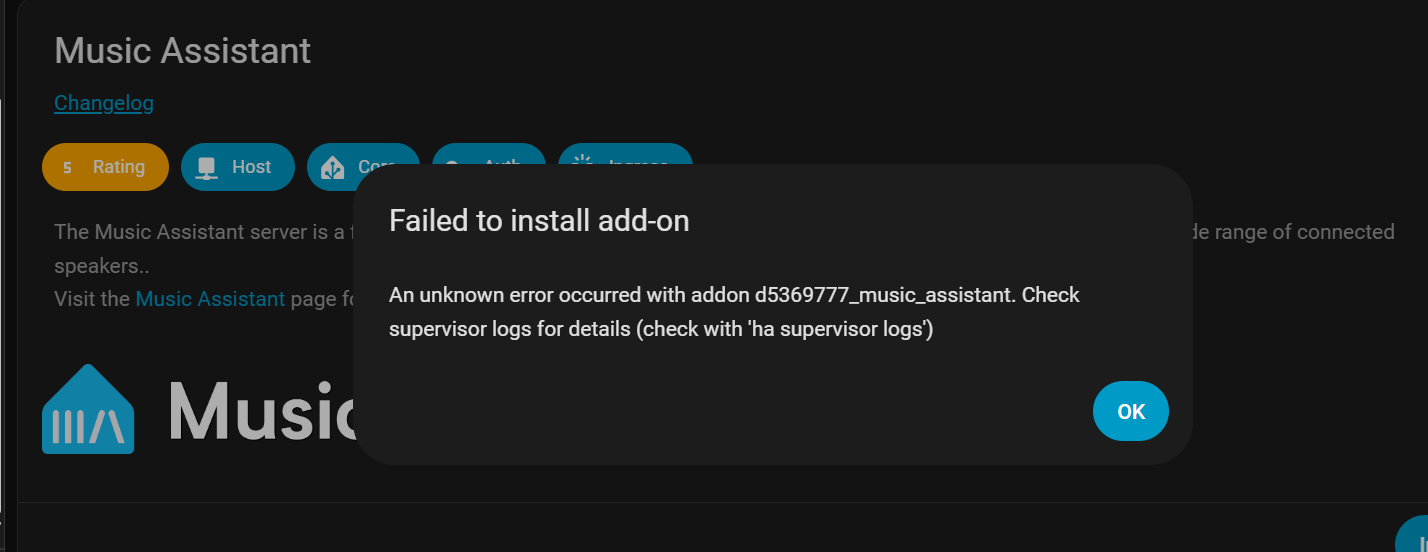

evey time i try and add a add on i get the following message still new to HA so can anyone help
i am runnung HA in virtubox on Windows 11
An unknown error occurred with addon a0d7b954_uptime-kuma. Check supervisor logs for details (check with ‘ha supervisor logs’)

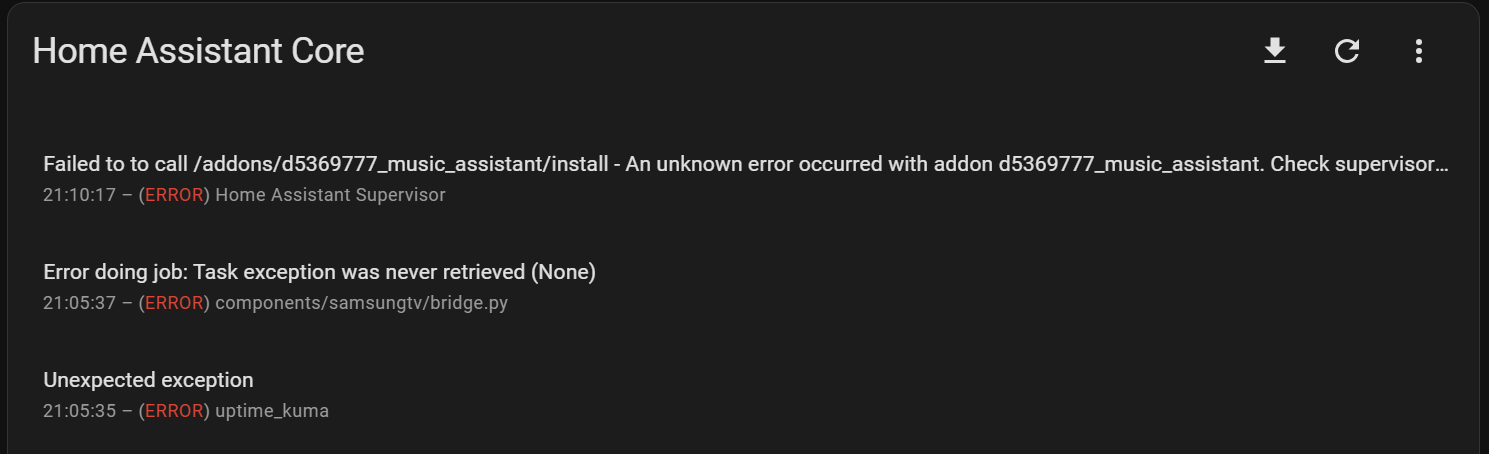

Still having same issue
this is what logs say
Logger: homeassistant.components.hassio
Source: components/hassio/websocket_api.py:145
integration: Home Assistant Supervisor (documentation, issues)
First occurred: 20:57:49 (1 occurrence)
Last logged: 20:57:49
Failed to to call /addons/cb646a50_get/install - An unknown error occurred with addon cb646a50_get. Check supervisor logs for details (check with ‘ha supervisor logs’)
its the same for all add ons

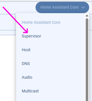

You are looking at the core log, not the supervisor log. There is a select option top right of the logs window.
