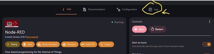

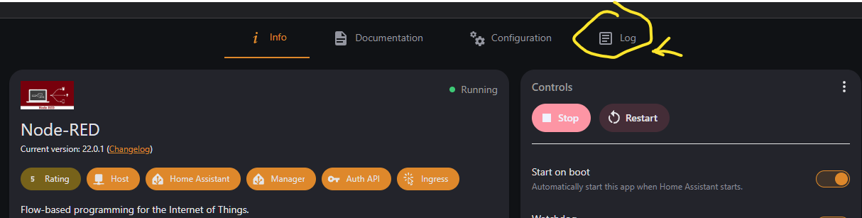

You noticed that besides start there’s also a button for it’s configuration?

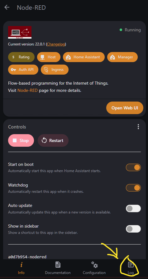

Not to mention one for log? Perhaps you could provide some more information?
Post the log from the app page.
on mobile
in a browser
Edit: you may have ssl enabled by default. On the config page of the app, switch off ssl, save and the app will restart.
