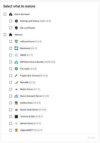

Yeah, I have configured the backups to store locally as well as through nabu-casa cloud. So I have three automatic backups to choose from, looking at once created October 25, 2025 at 4:52 AM. Do you think I should restore Home Assistant only or go include all the addons as well?
Unless you mucked around with the emqx & Z2M settings recently, you don’t need to restore the addons.

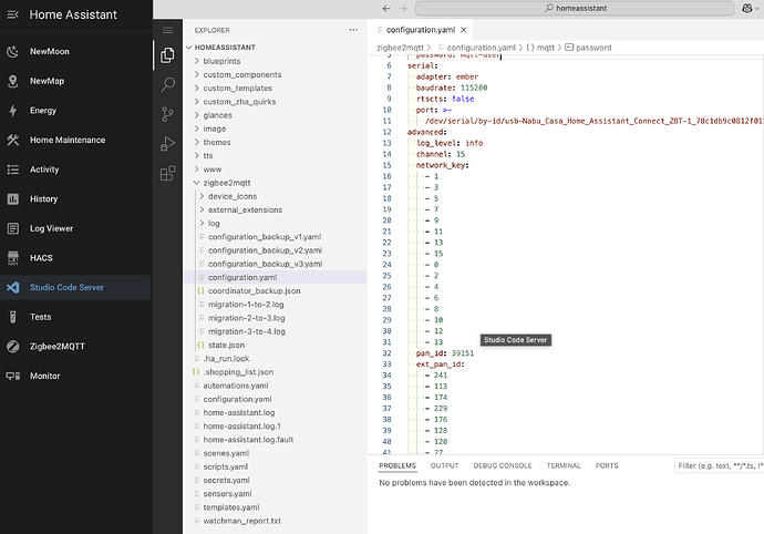

If you have the File Editor or Studio Code Server installed, you should be able to find a “configuration.yaml” file in a HomeAssistant/zigbee2mqtt folder (created by the Z2M add-on integration).

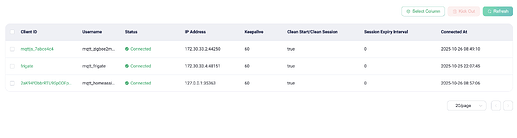

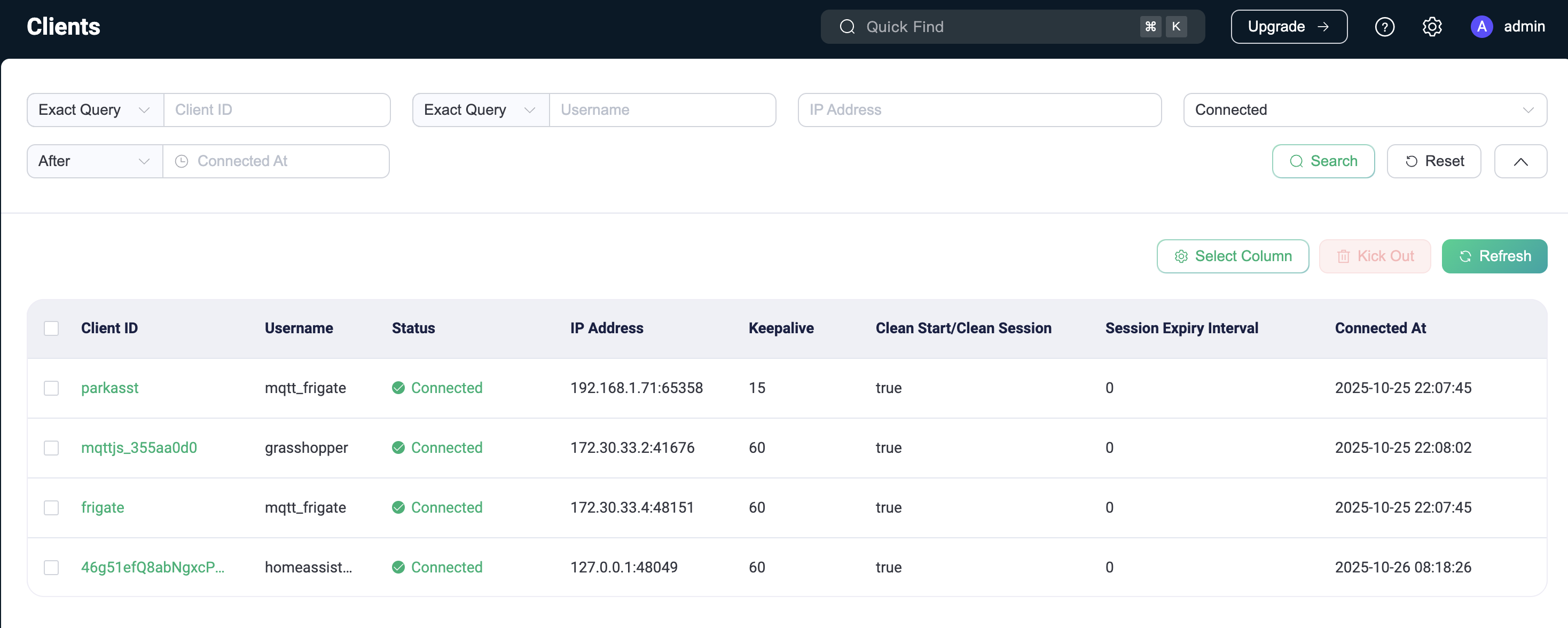

I can see the client is connected from within EMQX:
z2m should be the second client on the list (logged in as grasshopper);
homeassistant should be the last on the list.
