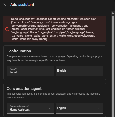

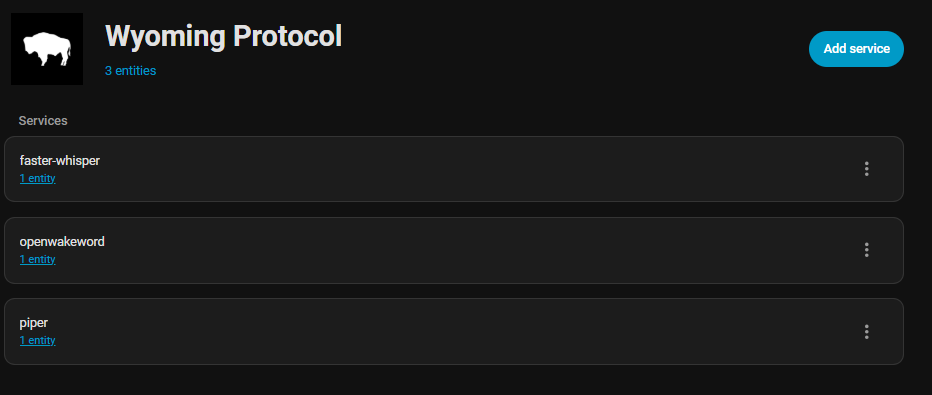

Added them under the Wyoming integration
And headed over to voice assistants to add them.
But when I click create, I get this error
Any ideas why?
It seems this might be a bug with Home Assistant. It occurs even with official integrations like Elevenlabs.
Tap the language selection field for stt and tts again and select an available option.
The voice selection field should also be displayed if everything is set up correctly.
