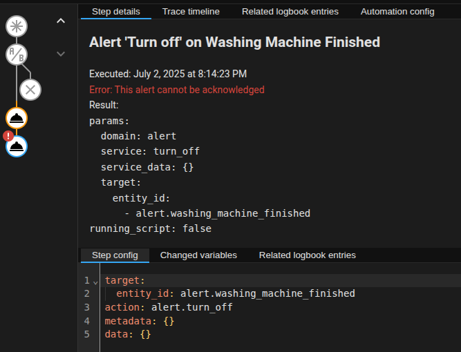

My automation for laundry status was working and somehow it broke. I now encounter the error in the subject" Error: This alert cannot be acknowledged". I have set the parameter to “can_acknowledge: false” in my alert.yaml file.
Is this a bug to report? Here’s a screenshot of the yaml code:

You have can_acknowledge set to false. So it can’t be acknowledged. Remove that.
Pretty sure that did it. If there’s a problem, I’ll come back.
Thank you!
Somehow 1/2 of the contact sensor is missing. :crazy_face: Go figure…
So… the “acknowledgement” wasn’t the problem after all. I was skeptical of that solution since the automation had been working well for ~6 months. The fact that the contact sensor wasn’t picking up the washing machine door opening and closing was the issue.
