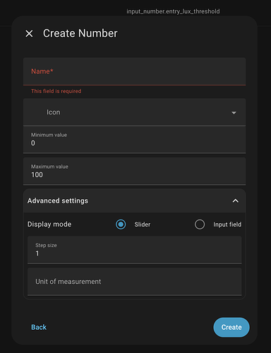

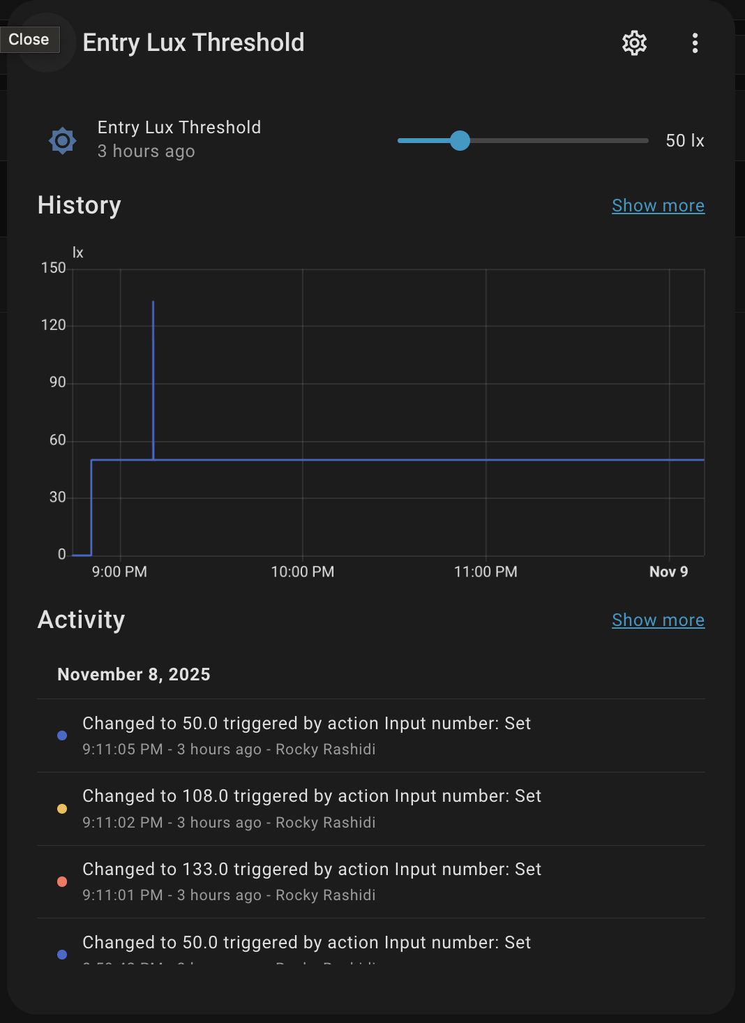

Did you recently create a Helper that has a template ?
yes i created this
Maybe show how you created this ?
Are these errors that occurred when you were working through the template logic? Clear your log, reboot HA and post any related errors…
basically just helpers → filled out this form. Then i use it in this automation

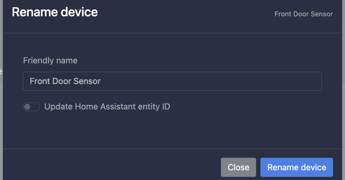

It doesnt seem like it its related to a helper @francisp @LiQuid_cOOled , Its when I got edit the name of a motion sensor in z2mqtt , and i also check “update in home assistant”
Was the name already used previously when trying to edit the name via Z2M?
If not, did you update the automation’s target entity to include the new entity name?
no the name wasnt used previously and this sensor isnt even in an automation. I can change the device name to anything, like “foo” and i’ll get this error

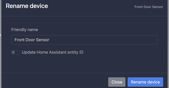

Have you changed multiple entity names via Z2M’s dashboard?
when i change the name of any device in z2M and i have “Update Home Assistant entity ID” checked, this error shows up.

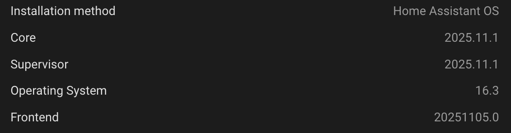

Please provide your system info
Installation method ?
Core ?
Supervisor ?
Operating System ?
Frontend ?
How is Z2M and your broker installed as well?
HA OS running in VM
where do i find the rest?
Z2M and Broker and installed via add ons
Settings(gear icon) in the sidebar and About tab at the very bottom

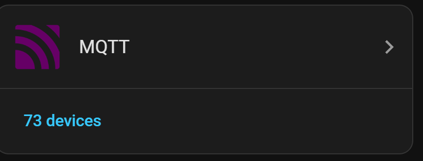

You are up to date. I run my Z2M and broker in separate docker containers so I am unsure if your renaming entities via Z2M are taking in HA. When you change the name in the Z2M UI, does the entity name change in the MQTT integration entity list?
if i check this box, yes but for this specific device it doesnt
Alter the friendly name temporarily and see if it takes.
