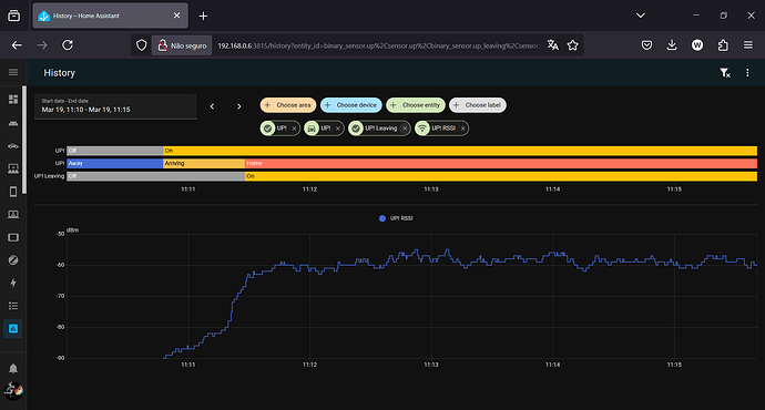

My garage is made of bricks and concrete and my gate is metal,
detection happens at about 20/30 meters
