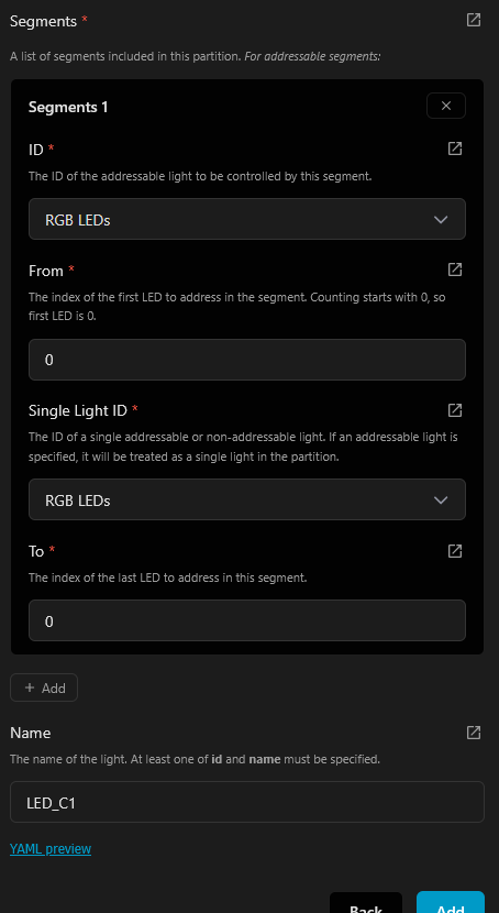

When using the visual editor, I must fill in ID, From, To, and Single Light ID.
However, Single Light ID is exclusive from the other values, so I then need to go back and edit it in the YAML.

This wasn’t a real impediment to what I was doing (I copy pasted the YAML portions, rather than doing the visual editor 10 times). It’s more so odd to me that conflicting values are all mandatory, when inputing those conficlting values immediate breaks the script.
