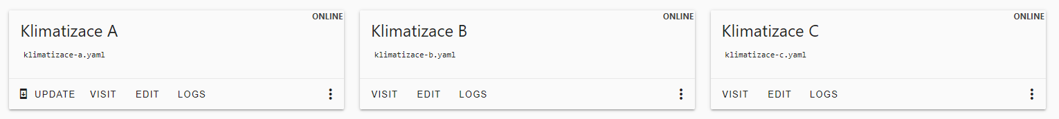

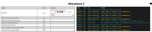

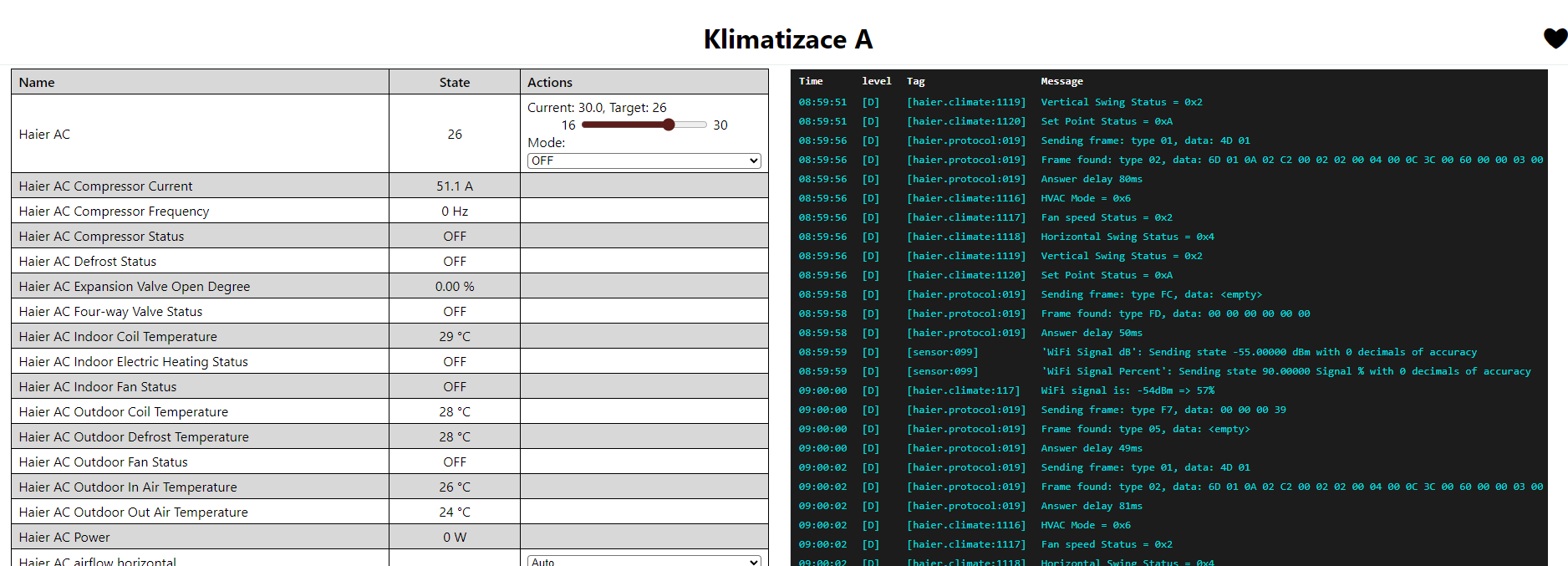

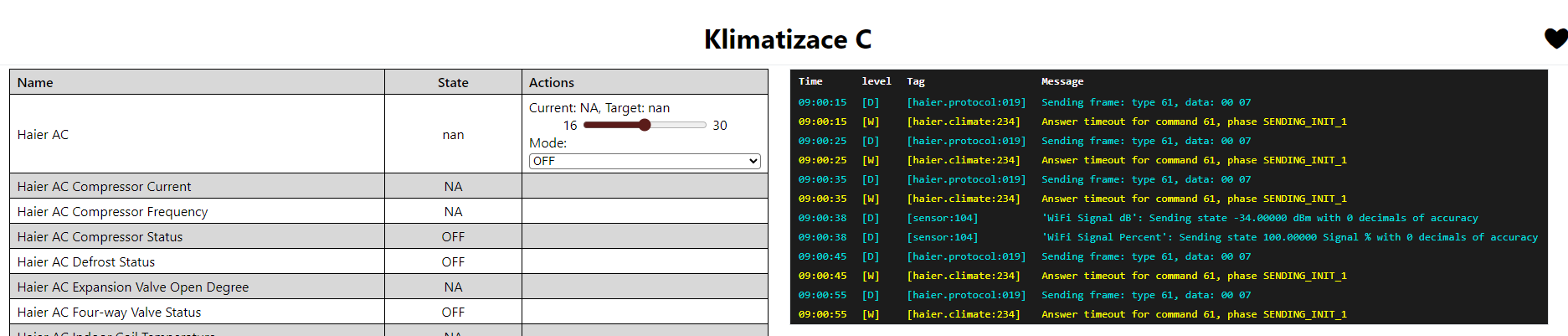

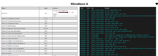

Can confirm, latest ESPHOME update breaks the integration.
1/3 my AC is not updated yet and works OK. Two of them are now at ESPHOME 2025.7.2 and stopped working (Answer timeout for command 61).

@Alloc186
In your case looks like serial port is not working. Are you using something that is not related to Haier AC like BT proxy or some other havy component?

Hmm, maybe the problem is with esp32-s3-devkitc-1 board and new update…
