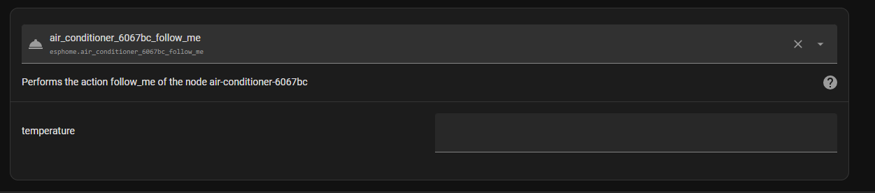

Now I have this Action in my HA:
I don’t know to use this action in some automation because there is a field “temperature” which must be filled with some number.
So, I want to create automation which will transfer value from my temperature sensor into this “temperature” field in that action, but don’t know how to do that :relieved:
