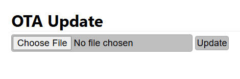

If you put this into your ESP YAML code, you will get an OTA button when you click on “Visit” or log on to the device IP address…
web_server:
  port: 80
