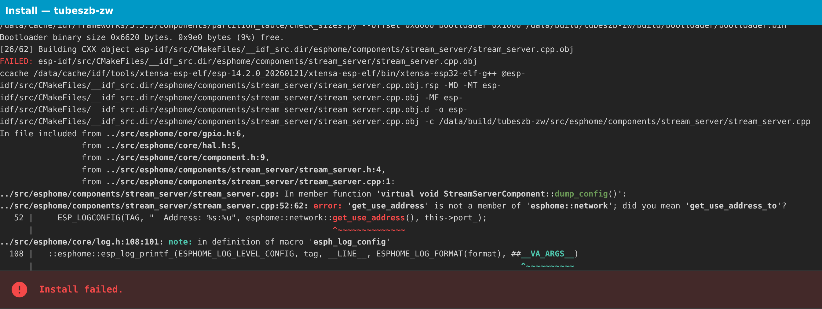

I have a tubes-zw ESP POE coordinator that has worked fine for several years. I regularly update the ESP home builder but do not always update the devices unless there is a specific firmware update for them.
I tried to update the device 2 weeks ago as there was an update (2026-8-1) from my current version 2026-6-5 and it failed with the following error:
I followed the ESP home builder instructions to clean the build folder and reset the environment but it did not work. I waited for a few more ESP home updates to see if they would clear the error but that has also not worked.
I am not much of a programmer but the error seems to indicate there is a syntax error in the build code for the device in relation to how ESP home now compiles the build file.

Be sure you are using the latest config from https://github.com/tube0013/TubesZB-ESPHome-Builder/tree/main/manifests and be sure you clear your esphome build dir and cache as this was fixed last month for the 2026.7 esphome release.
One note on the newest yaml, it changes the connection for zwave to use the esphome zwave-proxy component so stream server is not used at all on the zwave side anymore. It does require changing the port address from tcp:// to esphome:// and removing the port.
https://tube0013.github.io/tube_gateways/getting-started/z-wave-proxy-update/

Ok, I used the tubes-zw yaml file and commented out the 2 js settings, this compiled and downloaded.
I then changed the connection in the zwavejsui setting from tcp to esphome and restarted, comms all good.
