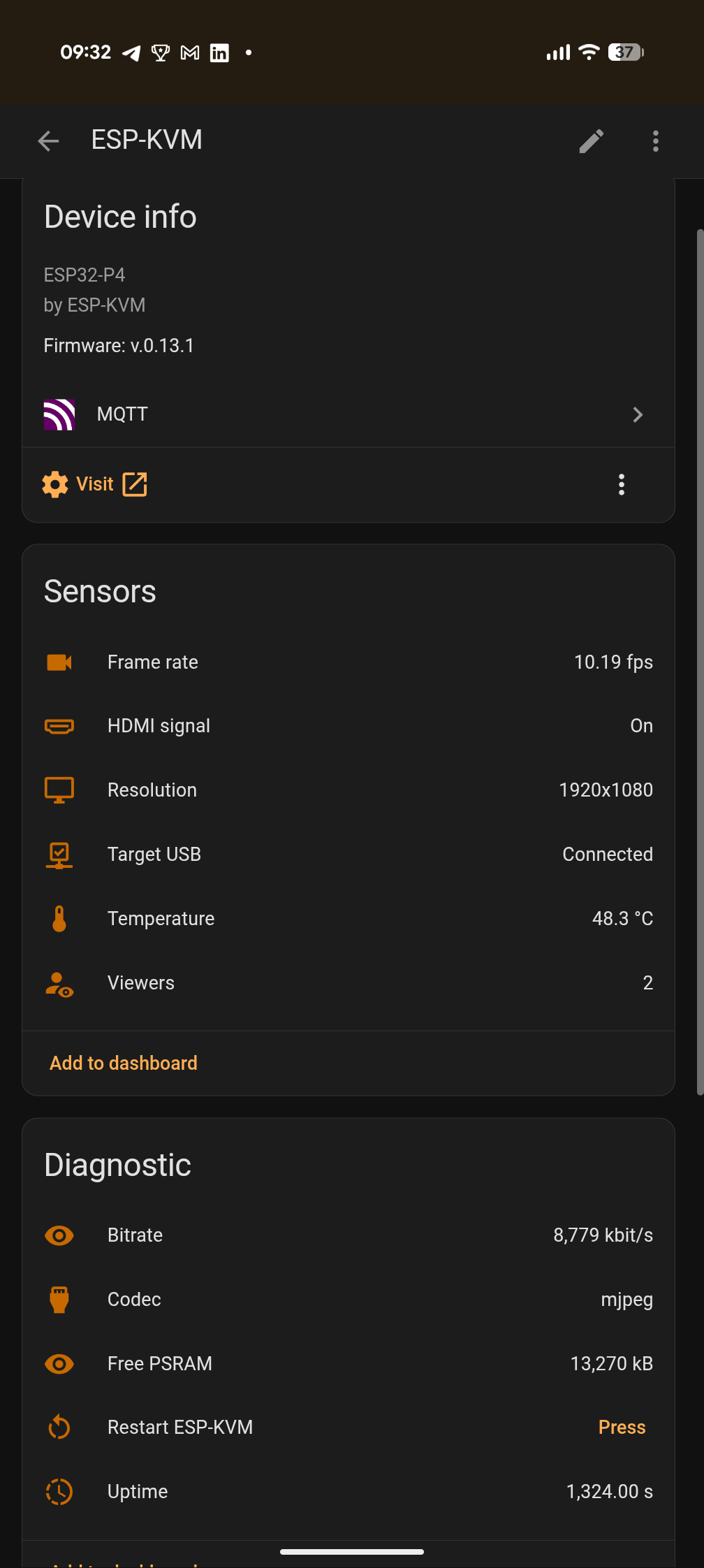

What lands in HA
Turn on MQTT in the device’s settings, point it at your broker, and it publishes discovery configs on connect - no YAML, no custom component. One device, with:
Sensors - temperature, viewers connected, frame rate, resolution, codec, bitrate, uptime, free PSRAM.
Binary sensors - HDMI signal (is the target actually putting out video?), target USB (has the target enumerated the emulated keyboard?), and target power if you have wired the ATX header.
Buttons - power, reset, force off (holds the power line), Wake-on-LAN, and restart the ESP-KVM itself (diagnostic).
Screen alert - a binary sensor with device_class: problem, plus a sensor holding the words that set it off. The firmware reads the target’s screen as characters, not as a picture, so you can give it a list of phrases to watch for - kernel panic, No boot device, Press F1 to continue - and it tells HA when one of them is on the screen and which ones. That is a machine reporting its own bad news while its OS is not running to report anything.
Availability is a proper LWT topic, so the device greys out in HA when it drops off, and telemetry publishes on an interval you set (30 s default). The screen alert does not wait for that interval - it is watched separately and published within a couple of seconds of the words appearing, because “the target just printed kernel panic” is not a thing to hear about half a minute later.
