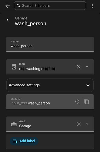

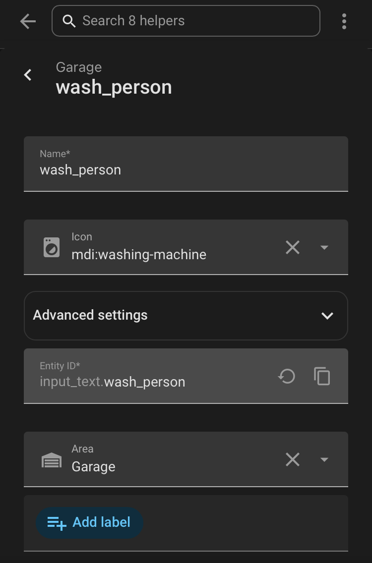

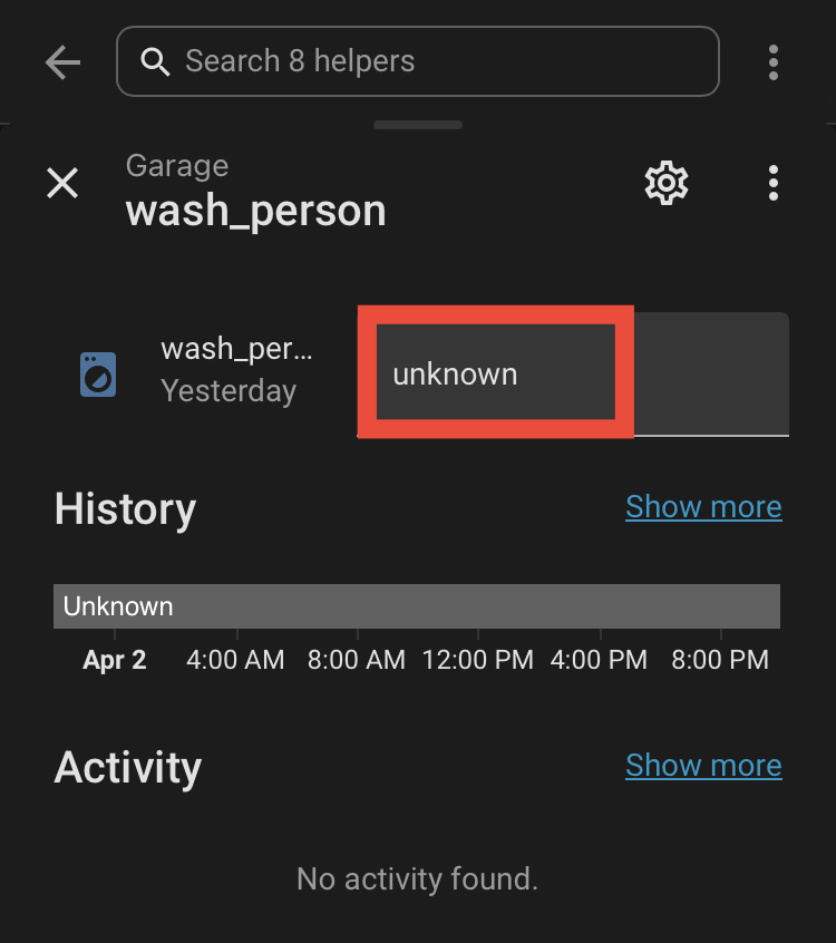

Neither of the “homeassistant.service:” below ever change the value of wash_person, a HELPER text_input in Home Assistant. Pictures below. The top one (5s interval) was created as a debug. It is the bottom (15s interval) that I really want to work. The text_input value is always set to “Unknown”
The ESP has been granted permission to perform Home Assistant actions.

UPDATE:
Unfortunately, this code does not pass the string to HA,
If I change the very last line of the code above with the last line from the code below, it does not work.
