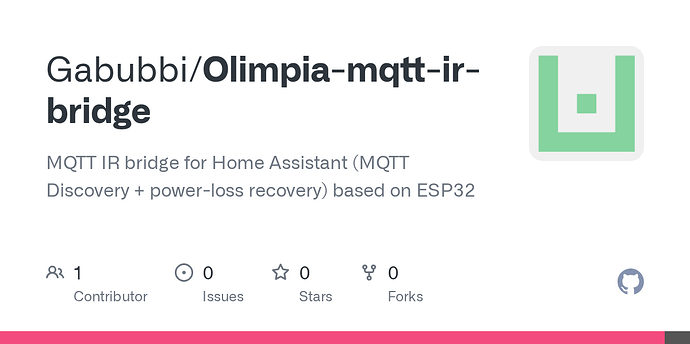

I now have the full source code, documentation, and a tagged stable release publicly available:
(v1.0.0 – initial stable release)
The repository includes:
  • the complete ESP32 firmware
  • MQTT topic structure and supported commands
  • Home Assistant MQTT Discovery integration
  • a power-loss recovery macro
  • example configuration files
  • tested library versions
