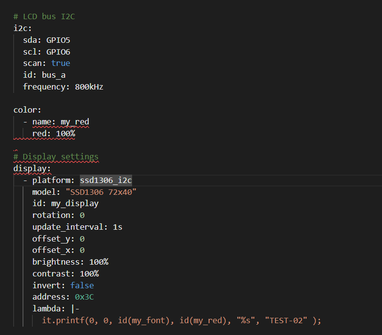

Define a color and use it with the text.
color:
  - name: my_red
    red: 100%

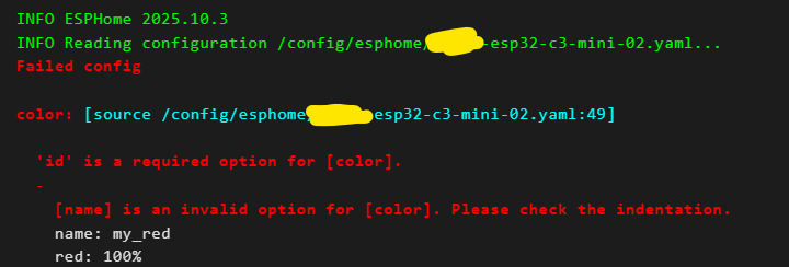

    it.printf(0, 0, id(my_font), id(my_red), "%s", "TEST-02" );
I am getting this error. I tried green and also yellow:

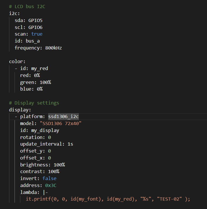

I tired this but the panel does not change color:

I only know split color ssd1306’s, where a part of the screen is color A and the other part color B, but you can’t change te color of that part. see also: SSD1306-Based OLED Display - DONE.LAND.
Hi, thanks from the info. When I got them, it was yellow and blue. However, now it is just white. Any way I can get the blue and yellow to work even if it is yellow at the top and blue at the bottom.
Thanks
No idea, they’re monochrome, so they can’t change color. You’re talking about “them”, which sounds like more than one. Maybe you have both a white and a blue/green one and accidentally mixed them up?
