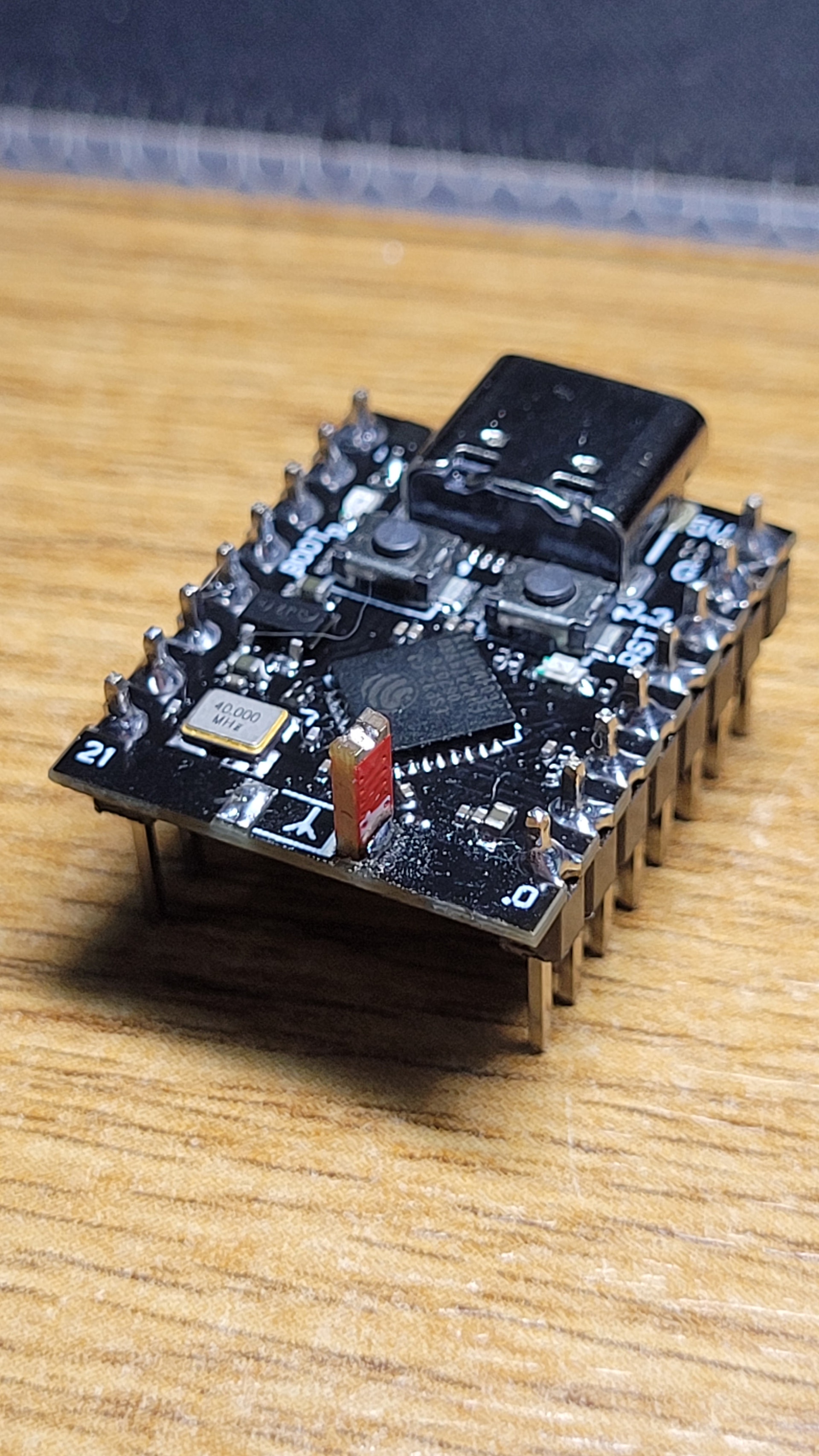

In my case, rotating the antenna 90° surprisingly improved the connection; now the Wi-Fi connects instantly where before it couldn’t even connect on its own.

Maybe rotating only the antenna removed one end from ground leaving more signal on the air instead of being sent on the negative side of his power supply ??

It seems the C3 Super Mini is poorly designed and manufactured. It is cheap. It appears that you might not even get what you paid for.

Ok I elaborate it better.. if his c3 is one with missing caps in antenna matching network, removing ground side from antenna could lead to a better impedance match and so a better rf irradiation from that ceramic dummy load.
