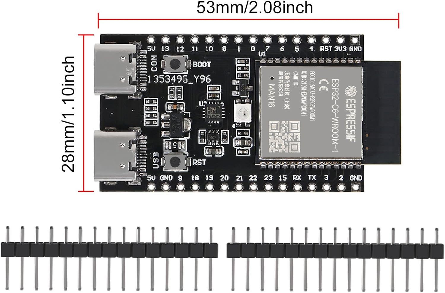

Esp32-C6 + HLKLD2410 mmwave sensor, no data reporting
Ive been fussing with the esp32-c6 first issue was setting it up with esp home, which is only successful by doing it here https://web.esphome.io/. Not sure if its because its not sure why.
I know anyone with this board is googling and looking for answers, so this is to help those guys
The code that got it working to connect to esp home is below

How i have my esp connected to my sensor
ESP32-C6 HLKLD2410C
Ground (GND) Ground (GND)
TX RX
RX TX
5v VCC

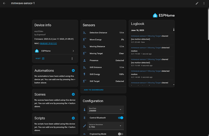

Will try when i get some time, since then something told me to try it on my only esp32-wroom was getting same error then i checked the HLKRadarTool app for the sensor and the did factory reset and notice the baud rate was never set once setting it to 25600 it started receiving data.
ESP32-Wroom Code

ESP32-Wroom Logs
INFO ESPHome 2025.5.2
INFO Reading configuration /config/esphome/esphome-web-7fd7cc.yaml...
INFO Starting log output from 192.168.12.124 using esphome API
INFO Successfully connected to esphome-web-7fd7cc @ hidden in 0.005s
INFO Successful handshake with esphome-web-7fd7cc @ hidden in 0.035s
[03:24:31][I][app:115]: ESPHome version 2025.5.2 compiled on Jun 17 2025, 21:09:21
[03:24:31][C][wifi:600]: WiFi:
[03:24:31][C][wifi:428]:   Local MAC: hidden
[03:24:31][C][wifi:433]:   SSID: [redacted]
[03:24:31][C][wifi:436]:   IP Address: hiden
[03:24:31][C][wifi:439]:   BSSID: [redacted]
[03:24:31][C][wifi:441]:   Hostname: 'esphome-web-7fd7cc'
[03:24:31][C][wifi:443]:   Signal strength: -39 dB ▂▄▆█
[03:24:31][C][wifi:447]:   Channel: 2
[03:24:31][C][wifi:448]:   Subnet: 255.255.255.0
[03:24:31][C][wifi:449]:   Gateway: 192.168.12.1
[03:24:31][C][wifi:450]:   DNS1: 192.168.12.1
[03:24:31][C][wifi:451]:   DNS2: 0.0.0.0
[03:24:31][C][logger:224]: Logger:
[03:24:31][C][logger:225]:   Max Level: DEBUG
[03:24:31][C][logger:226]:   Initial Level: DEBUG
[03:24:31][C][logger:228]:   Log Baud Rate: 115200
[03:24:31][C][logger:229]:   Hardware UART: UART0
[03:24:31][C][logger:233]:   Task Log Buffer Size: 768
[03:24:31][C][uart.idf:159]: UART Bus 1:
[03:24:31][C][uart.idf:160]:   TX Pin: GPIO17
[03:24:31][C][uart.idf:161]:   RX Pin: GPIO16
[03:24:31][C][uart.idf:163]:   RX Buffer Size: 256
[03:24:31][C][uart.idf:165]:   Baud Rate: 256000 baud
[03:24:31][C][uart.idf:166]:   Data Bits: 8
[03:24:31][C][uart.idf:167]:   Parity: NONE
[03:24:31][C][uart.idf:168]:   Stop bits: 1
[03:24:31][D][uart_debug:114]: <<< F7:F6:F5
[03:24:31][D][uart_debug:114]: <<< F4:F3:F2:F1:0D:00:02:AA:03:34:00:52:45:00:64:59:00:55:00:F8

[03:24:31][C][ld2410:041]:     Device Class: 'distance'
[03:24:31][C][ld2410:041]:     State Class: ''
[03:24:31][C][ld2410:041]:     Unit of Measurement: 'cm'
[03:24:31][C][ld2410:041]:     Accuracy Decimals: 0
[03:24:31][C][ld2410:041]:     Icon: 'mdi:signal-distance-variant'
[03:24:31][C][ld2410:042]:   MovingTargetEnergySensor 'Move Energy'
[03:24:31][C][ld2410:042]:     State Class: ''
[03:24:32][C][ld2410:042]:     Unit of Measurement: '%'
[03:24:32][C][ld2410:042]:     Accuracy Decimals: 0
[03:24:32][C][ld2410:042]:     Icon: 'mdi:motion-sensor'
[03:24:32][C][ld2410:043]:   StillTargetEnergySensor 'Still Energy'
[03:24:32][C][ld2410:043]:     State Class: ''
[03:24:32][C][ld2410:043]:     Unit of Measurement: '%'
[03:24:32][C][ld2410:043]:     Accuracy Decimals: 0
[03:24:32][C][ld2410:043]:     Icon: 'mdi:flash'
[03:24:32][C][ld2410:044]:   DetectionDistanceSensor 'Detection Distance'
[03:24:32][C][ld2410:044]:     Device Class: 'distance'
[03:24:32][C][ld2410:044]:     State Class: ''
[03:24:32][C][ld2410:044]:     Unit of Measurement: 'cm'
[03:24:32][C][ld2410:044]:     Accuracy Decimals: 0
[03:24:32][C][ld2410:044]:     Icon: 'mdi:signal-distance-variant'
[03:24:32][C][ld2410:046]:   NthGateStillSesnsor 'g0 still energy'
[03:24:32][C][ld2410:046]:     State Class: ''
[03:24:32][C][ld2410:046]:     Unit of Measurement: '%'
[03:24:32][C][ld2410:046]:     Accuracy Decimals: 0
[03:24:32][C][ld2410:046]:     Icon: 'mdi:flash'
[03:24:32][C][ld2410:046]:   NthGateStillSesnsor 'g1 still energy'
[03:24:32][C][ld2410:046]:   NthGateStillSesnsor 'g2 still energy'
[03:24:32][C][ld2410:046]:   NthGateStillSesnsor 'g3 still energy'
[03:24:32][C][ld2410:046]:   NthGateStillSesnsor 'g4 still energy'
[03:24:32][C][ld2410:046]:   NthGateStillSesnsor 'g5 still energy'
[03:24:32][C][ld2410:046]:   NthGateStillSesnsor 'g6 still energy'
[03:24:32][C][ld2410:046]:   NthGateStillSesnsor 'g7 still energy'
[03:24:32][C][ld2410:046]:   NthGateStillSesnsor 'g8 still energy'
[03:24:32][C][ld2410:049]:   NthGateMoveSesnsor 'g0 move energy'
[03:24:32][C][ld2410:049]:     State Class: ''
[03:24:32][C][ld2410:049]:     Unit of Measurement: '%'
[03:24:32][C][ld2410:049]:     Accuracy Decimals: 0
[03:24:32][C][ld2410:049]:     Icon: 'mdi:motion-sensor'
[03:24:32][C][ld2410:049]:   NthGateMoveSesnsor 'g1 move energy'
[03:24:32][C][ld2410:049]:   NthGateMoveSesnsor 'g2 move energy'
[03:24:32][C][ld2410:049]:   NthGateMoveSesnsor 'g3 move energy'
[03:24:32][C][ld2410:049]:   NthGateMoveSesnsor 'g4 move energy'
[03:24:32][C][ld2410:049]:   NthGateMoveSesnsor 'g5 move energy'
[03:24:32][C][ld2410:049]:   NthGateMoveSesnsor 'g6 move energy'
[03:24:32][C][ld2410:049]:   NthGateMoveSesnsor 'g7 move energy'
[03:24:32][C][ld2410:049]:   NthGateMoveSesnsor 'g8 move energy'
[03:24:32][C][ld2410:053]:   VersionTextSensor 'Firmware Version'
[03:24:32][C][ld2410:053]:     Icon: 'mdi:chip'
[03:24:32][C][ld2410:054]:   MacTextSensor 'MAC'
[03:24:32][C][ld2410:054]:     Icon: 'mdi:bluetooth'
[03:24:32][C][ld2410:057]:   LightFunctionSelect 'Light Function'
[03:24:32][C][ld2410:057]:     Icon: 'mdi:lightbulb'
[03:24:32][C][ld2410:058]:   OutPinLevelSelect 'Out Pin Level'
[03:24:32][C][ld2410:058]:     Icon: 'mdi:scale'
[03:24:32][C][ld2410:059]:   DistanceResolutionSelect 'Distance Resolution'
[03:24:32][C][ld2410:059]:     Icon: 'mdi:ruler'
[03:24:32][C][ld2410:060]:   BaudRateSelect 'Baud Rate'
[03:24:32][C][ld2410:060]:     Icon: 'mdi:thermometer'
[03:24:32][C][ld2410:063]:   LightThresholdNumber 'Light Threshold'
[03:24:32][C][ld2410:063]:     Icon: 'mdi:lightbulb'
[03:24:32][C][ld2410:063]:     Device Class: 'illuminance'
[03:24:32][C][ld2410:064]:   MaxStillDistanceGateNumber 'Max Still Distance Gate'
[03:24:32][C][ld2410:064]:     Icon: 'mdi:motion-sensor'
[03:24:32][C][ld2410:064]:     Device Class: 'distance'
[03:24:32][C][ld2410:065]:   MaxMoveDistanceGateNumber 'Max Move Distance Gate'
[03:24:32][C][ld2410:065]:     Icon: 'mdi:motion-sensor'
[03:24:32][C][ld2410:065]:     Device Class: 'distance'
[03:24:32][C][ld2410:066]:   TimeoutNumber 'Timeout'
[03:24:32][C][ld2410:066]:     Icon: 'mdi:timelapse'
[03:24:32][C][ld2410:066]:     Unit of Measurement: 's'
[03:24:32][C][ld2410:068]:   Still Thresholds Number 'g0 still threshold'
[03:24:32][C][ld2410:068]:     Icon: 'mdi:motion-sensor'
[03:24:32][C][ld2410:068]:     Unit of Measurement: '%'
[03:24:32][C][ld2410:068]:     Device Class: 'signal_strength'
[03:24:32][C][ld2410:068]:   Still Thresholds Number 'g1 still threshold'
[03:24:32][C][ld2410:068]:   Still Thresholds Number 'g2 still threshold'
[03:24:32][C][ld2410:068]:   Still Thresholds Number 'g3 still threshold'
[03:24:32][C][ld2410:068]:   Still Thresholds Number 'g4 still threshold'
[03:24:32][C][ld2410:068]:   Still Thresholds Number 'g5 still threshold'
[03:24:32][C][ld2410:068]:   Still Thresholds Number 'g6 still threshold'
[03:24:32][C][ld2410:068]:   Still Thresholds Number 'g7 still threshold'
[03:24:32][C][ld2410:068]:   Still Thresholds Number 'g8 still threshold'
[03:24:32][C][ld2410:071]:   Move Thresholds Number 'g0 move threshold'
[03:24:32][C][ld2410:071]:     Icon: 'mdi:motion-sensor'
[03:24:32][C][ld2410:071]:     Unit of Measurement: '%'
[03:24:32][C][ld2410:071]:     Device Class: 'signal_strength'
[03:24:32][C][ld2410:071]:   Move Thresholds Number 'g1 move threshold'
[03:24:32][C][ld2410:071]:   Move Thresholds Number 'g2 move threshold'
[03:24:32][C][ld2410:071]:   Move Thresholds Number 'g3 move threshold'
[03:24:32][C][ld2410:071]:   Move Thresholds Number 'g4 move threshold'
[03:24:32][C][ld2410:071]:   Move Thresholds Number 'g5 move threshold'
[03:24:32][C][ld2410:071]:   Move Thresholds Number 'g6 move threshold'
[03:24:32][C][ld2410:071]:   Move Thresholds Number 'g7 move threshold'
[03:24:32][C][ld2410:071]:   Move Thresholds Number 'g8 move threshold'
[03:24:33][C][ld2410:071]:     Icon: 'mdi:motion-sensor'
[03:24:33][C][ld2410:071]:     Unit of Measurement: '%'
[03:24:33][C][ld2410:071]:     Device Class: 'signal_strength'
[03:24:33][D][uart_debug:114]: <<< F7:F6:F5
[03:24:33][C][ld2410:075]:   Throttle_ : 1000ms
[03:24:33][C][ld2410:076]:   MAC Address : E6:F8:10:24:37:85
[03:24:33][C][ld2410:077]:   Firmware Version : 2.44.24073110
[03:24:33][D][uart_debug:114]: >>> FD:FC:FB:FA:04:00:FF:00:01:00:04:03:02:01:FD:FC:FB:FA:02:00:A0:00:04:03:02:01:FD:FC:FB:FA:04:00:A5:00:01:00:04:03:02:01:FD:FC:FB:FA:02:00:AB:00:04:03:02:01:FD:FC:FB:FA:02:00:AE:00:04:03:02:01:FD:FC:FB:FA:02:00:61:00:04:03:02:01:FD:FC:FB:FA:02:00:FE:00:04:03:02:01
[03:24:33][D][uart_debug:114]: <<< F4:F3:F2:F1:0D:00:02:AA:02:34:00:00:34:00:64:52:00:55:00:F8
[03:24:33][D][binary_sensor:036]: 'Moving Target': Sending state OFF
[03:24:33][D][sensor:093]: 'Moving Distance': Sending state 52.00000 cm with 0 decimals of accuracy
[03:24:33][D][sensor:093]: 'Move Energy': Sending state 0.00000 % with 0 decimals of accuracy
[03:24:33][D][sensor:093]: 'Still Distance': Sending state 52.00000 cm with 0 decimals of accuracy
[03:24:33][D][sensor:093]: 'Detection Distance': Sending state 82.00000 cm with 0 decimals of accuracy
[03:24:33][D][uart_debug:114]: <<< F7:F6:F5:F4:F3:F2:F1:0D:00:02:AA:03:4C:00:64:34:00:64:4C:00:55:00:F8
[03:24:33][D][uart_debug:114]: <<< F7:F6:F5:F4:F3:F2:F1:0D:00:02:AA:03:44:00:52:4C:00:64:4A:00:55:00:F8
[03:24:33][D][uart_debug:114]: <<< F7:F6:F5:F4:F3:F2:F1:0D:00:02:AA:03:4B:00:53:44:00:64:47:00:55:00:F8
[03:24:33][D][uart_debug:114]: <<< F7:F6:F5:F4:F3:F2:F1:0D:00:02:AA:03:4F:00:45:4B:00:64:45:00:55:00:F8
[03:24:33][D][uart_debug:114]: <<< F7:F6:F5:F4:F3:F2:F1:0D:00:02:AA:03:3A:00:63:4F:00:64:44:00:55:00:F8
[03:24:33][D][uart_debug:114]: <<< F7:F6:F5:F4:F3:F2:F1:0D:00:02:AA:03:43:00:42:3A:00:64:42:00:55:00:F8
[03:24:33][D][uart_debug:114]: <<< F7:F6:F5:F4:F3:F2:F1:0D:00:02:AA:03:34:00:43:43:00:64:3E:00:55:00:F8
[03:24:33][D][uart_debug:114]: <<< F7:F6:F5:F4:F3:F2:F1:0D:00:02:AA:03:40:00:3C:34:00:64:3D:00:55:00:F8
[03:24:33][D][uart_debug:114]: <<< F7:F6:F5:F4:F3:F2:F1:0D:00:02:AA:02:40:00:00:40:00:64:3C:00:55:00:F8
[03:24:33][D][uart_debug:114]: <<< F7:F6:F5:F4:F3:F2:F1:0D:00:02:AA:02:40:00:00:40:00:64:3B:00:55:00:F8
[03:24:33][D][uart_debug:114]: <<< F7:F6:F5:F4:F3:F2:F1:0D:00:02:AA:02:40:00:00:40:00:64:3A:00:55:00:F8
[03:24:33][E][ld2410:336]: Error with last command : incorrect Header
[03:24:33][D][uart_debug:114]: <<< F7:F6:F5:32:32:28:1E:14:0F:0F:0F:0F:13:15:28:28:1E:1E:14:14:14:05:00:04:03:02:01:FD:FC:FB:FA:04:00:FE:01:00:00:04:03:02:01:F4:F3:F2:F1:0D:00:02:AA:02:4B:00:00:4B:00:64:37:00:55:00:F8
[03:24:33][D][uart_debug:114]: <<< F7:F6:F5:F4:F3:F2:F1:0D:00:02:AA:02:4B:00:00:4B:00:64:37:00:55:00:F8
[03:24:33][C][captive_portal:089]: Captive Portal:
[03:24:33][C][web_server:285]: Web Server:
[03:24:33][C][web_server:286]:   Address: esphome-web-7fd7cc.local:80
[03:24:33][C][mdns:120]: mDNS:
[03:24:33][C][mdns:121]:   Hostname: esphome-web-7fd7cc
[03:24:33][C][esphome.ota:073]: Over-The-Air updates:
[03:24:33][C][esphome.ota:074]:   Address: esphome-web-7fd7cc.local:3232
[03:24:33][C][esphome.ota:075]:   Version: 2
[03:24:33][C][safe_mode:018]: Safe Mode:
[03:24:33][C][safe_mode:019]:   Boot considered successful after 60 seconds
[03:24:33][C][safe_mode:021]:   Invoke after 10 boot attempts
[03:24:33][C][safe_mode:022]:   Remain in safe mode for 300 seconds
[03:24:33][C][api:170]: API Server:
[03:24:33][C][api:171]:   Address: esphome-web-7fd7cc.local:6053
[03:24:33][C][api:178]:   Using noise encryption: NO
[03:24:34][D][uart_debug:114]: <<< F7:F6:F5:F4:F3:F2:F1:0D:00:02:AA:02:4B:00:00:4B:00:64:37:00:55:00:F8
[03:24:34][D][uart_debug:114]: <<< F7:F6:F5:F4:F3:F2:F1:0D:00:02:AA:03:1E:00:43:4B:00:64:37:00:55:00:F8
[03:24:34][D][uart_debug:114]: <<< F7:F6:F5:F4:F3:F2:F1:0D:00:02:AA:02:1E:00:00:1E:00:64:31:00:55:00:F8
[03:24:34][D][sensor:093]: 'Moving Distance': Sending state 30.00000 cm with 0 decimals of accuracy
[03:24:34][D][sensor:093]: 'Still Distance': Sending state 30.00000 cm with 0 decimals of accuracy
[03:24:34][D][sensor:093]: 'Detection Distance': Sending state 49.00000 cm with 0 decimals of accuracy
[03:24:34][D][uart_debug:114]: <<< F7:F6:F5:F4:F3:F2:F1:0D:00:02:AA:03:1E:00:3B:1E:00:64:2C:00:55:00:F8
[03:24:34][D][uart_debug:114]: <<< F7:F6:F5:F4:F3:F2:F1:0D:00:02:AA:02:1E:00:00:1E:00:64:28:00:55:00:F8
[03:24:34][D][uart_debug:114]: <<< F7:F6:F5:F4:F3:F2:F1:0D:00:02:AA:02:1E:00:00:1E:00:64:24:00:55:00:F8
[03:24:34][D][uart_debug:114]: <<< F7:F6:F5:F4:F3:F2:F1:0D:00:02:AA:03:1E:00:33:1E:00:64:21:00:55:00:F8
[03:24:34][D][uart_debug:114]: <<< F7:F6:F5:F4:F3:F2:F1:0D:00:02:AA:02:1E:00:00:1E:00:64:1E:00:55:00:F8
[03:24:35][D][uart_debug:114]: <<< F7:F6:F5:F4:F3:F2:F1:0D:00:02:AA:02:1E:00:00:1E:00:64:00:00:55:00:F8
[03:24:35][D][sensor:093]: 'Detection Distance': Sending state 0.00000 cm with 0 decimals of accuracy
[03:24:36][D][uart_debug:114]: <<< F7:F6:F5:F4:F3:F2:F1:0D:00:02:AA:02:1E:00:00:1E:00:64:00:00:55:00:F8
[03:24:36][D][uart_debug:114]: <<< F7:F6:F5:F4:F3:F2:F1:0D:00:02:AA:02:1E:00:00:BC:00:64:22:00:55:00:F8
[03:24:36][D][uart_debug:114]: <<< F7:F6:F5:F4:F3:F2:F1:0D:00:02:AA:02:1E:00:00:BC:00:64:33:00:55:00:F8
[03:24:36][D][uart_debug:114]: <<< F7:F6:F5:F4:F3:F2:F1:0D:00:02:AA:02:1E:00:00:1E:00:64:2E:00:55:00:F8
[03:24:36][D][sensor:093]: 'Detection Distance': Sending state 46.00000 cm with 0 decimals of accuracy
[03:24:36][D][uart_debug:114]: <<< F7:F6:F5:F4:F3:F2:F1:0D:00:02:AA:02:1E:00:00:1E:00:64:2A:00:55:00:F8
[03:24:36][D][uart_debug:114]: <<< F7:F6:F5:F4:F3:F2:F1:0D:00:02:AA:02:1E:00:00:1E:00:64:26:00:55:00:F8
[03:24:36][D][uart_debug:114]: <<< F7:F6:F5:F4:F3:F2:F1:0D:00:02:AA:02:1E:00:00:1E:00:64:23:00:55:00:F8
[03:24:36][D][uart_debug:114]: <<< F7:F6:F5:F4:F3:F2:F1:0D:00:02:AA:02:1E:00:00:1E:00:64:20:00:55:00:F8
[03:24:37][D][uart_debug:114]: <<< F7:F6:F5:F4:F3:F2:F1:0D:00:02:AA:02:1E:00:00:1E:00:64:00:00:55:00:F8
[03:24:37][D][sensor:093]: 'Detection Distance': Sending state 0.00000 cm with 0 decimals of accuracy
[03:24:38][D][uart_debug:114]: <<< F7:F6:F5:F4:F3:F2:F1:0D:00:02:AA:02:1E:00:00:1E:00:64:00:00:55:00:F8
[03:24:39][D][uart_debug:114]: <<< F7:F6:F5:F4:F3:F2:F1:0D:00:02:AA:02:1E:00:00:1E:00:64:00:00:55:00:F8
