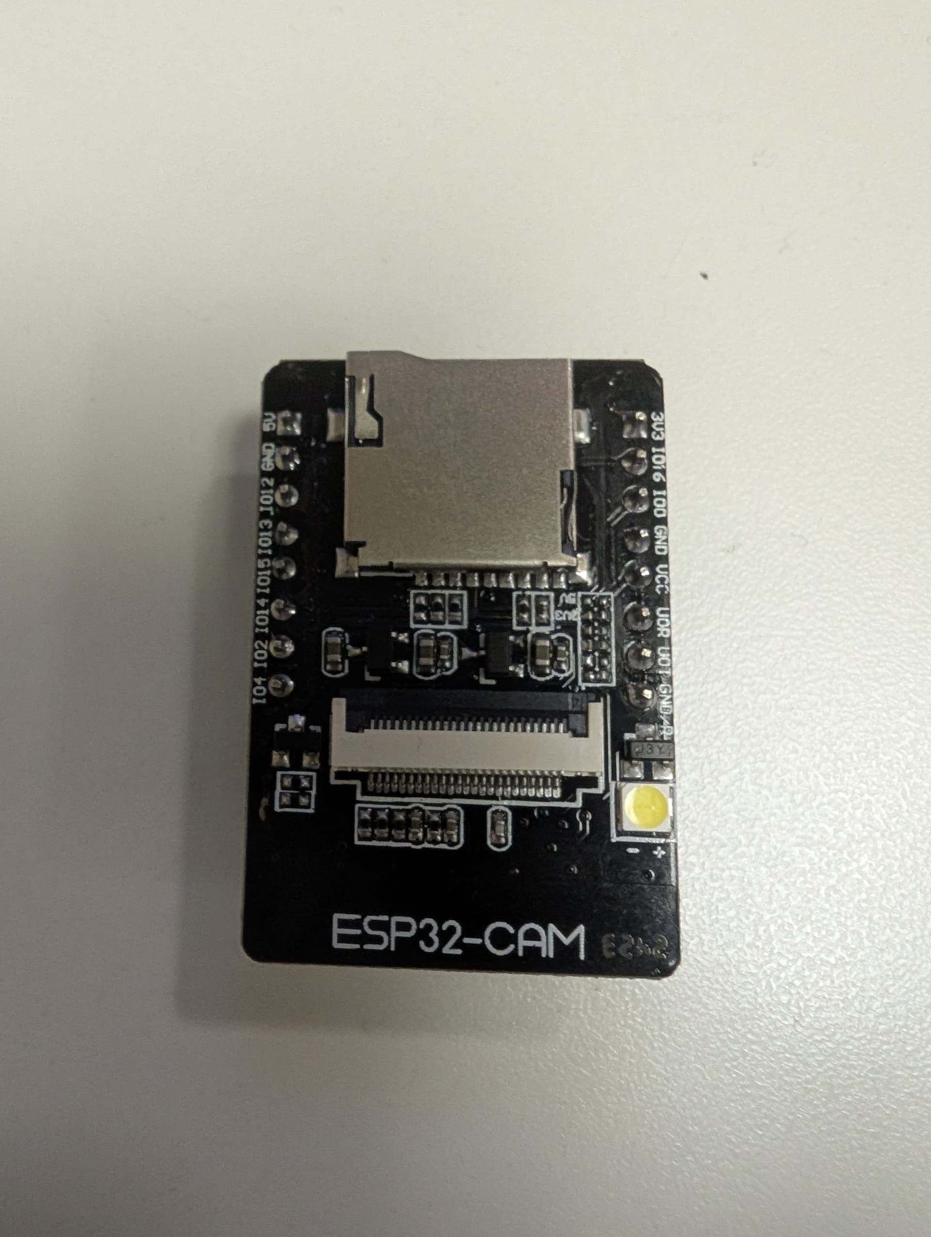

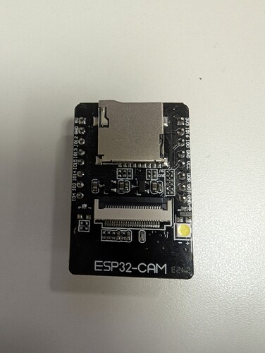

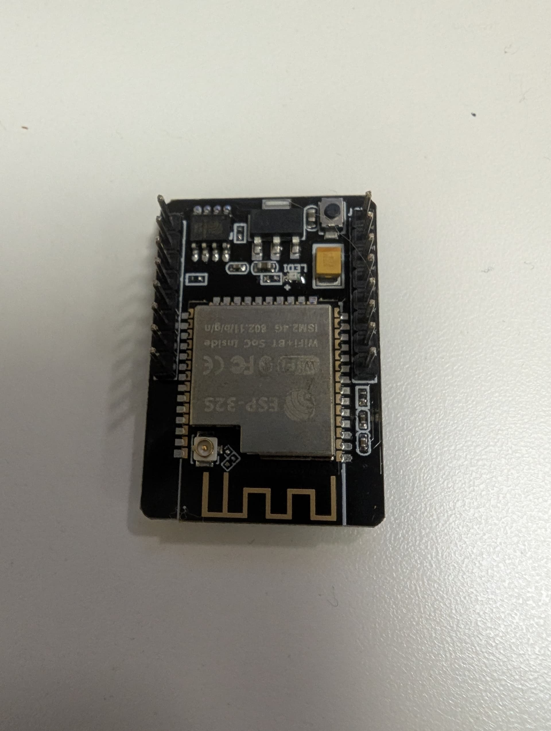

This is what I have, no usb connector. Not my first one but I don’t work with them all that often. I have a couple of esp32-S3’s with ethernet connection. They programmed up easily

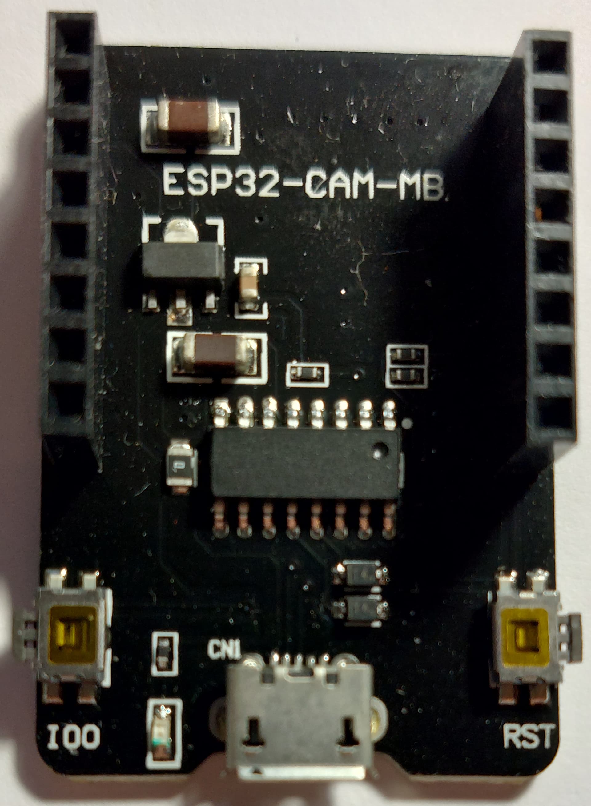

If you’re using a power supply module like the one pictured for your ESP_Cam, you usually don’t need to bridge GPIO0 to GND for programming; the board does this automatically.
It’s possible that you’re missing the necessary USB driver for the cable connection from your PC to the ESP_Cam power supply board.
If you open the Windows Device Manager without the USB cable connected, and then open it with the USB cable connected to the ESP_Cam, is there an additional COM port listed in the Device Manager?
If so, is it listed as an “Unknown Device”? If it’s an unknown device, you’re missing the driver. USB communication typically uses chips like the CH340, CP210X, or CP9102. Different chips require different drivers.
