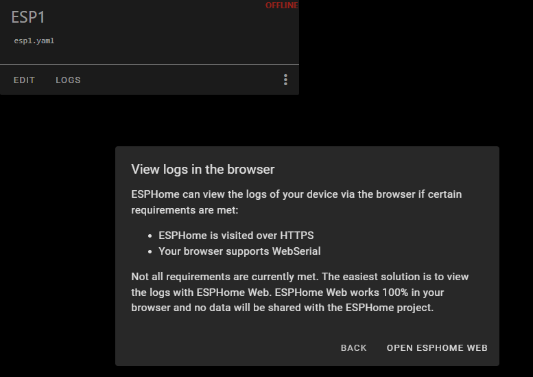

Everytime i try to press the log i get the 3 optons to connect to (this PC where i have my esp32 connected with USB cord and red light is on) i get this message. i think maybe i have some connection issues just not sure where to start.
Ok - so your device isn’t connected via USB, just using the browser via ESPHome web.
First - try Chrome instead of whatever browser you are using - that sometimes solves the https problem.

I did all your suggestion and still at step one. yes i can’t seem to be able to connect to the ESP board.
You have made life difficult for yourself if the devices are in different subnets, and you are using ESPHome web to flash them.
ESPHome builder uses mDNS to connect to devices by default. mDNS will not cross subnets.
I assume you originally flashed it using the option:
Plug into this computer
For devices connected via USB to this computer
Why can’t you edit the yaml and do that again? Otherwise - you have me very confused. :smiley:
