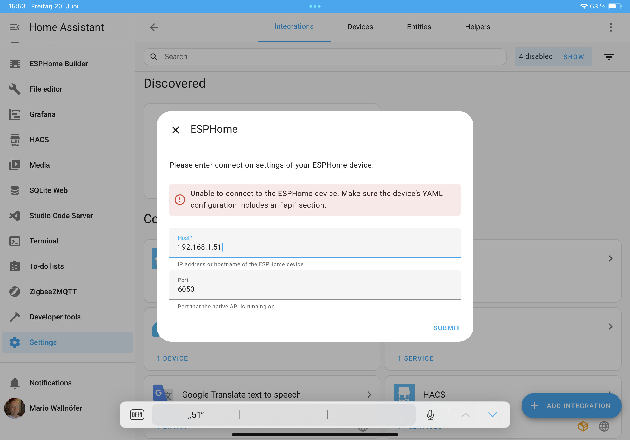

Try removing api
Did, but i am getting a error message in Homeassistant
Unable to connect to the ESPHome device. Make sure the device’s YAML configuration includes an api section.
