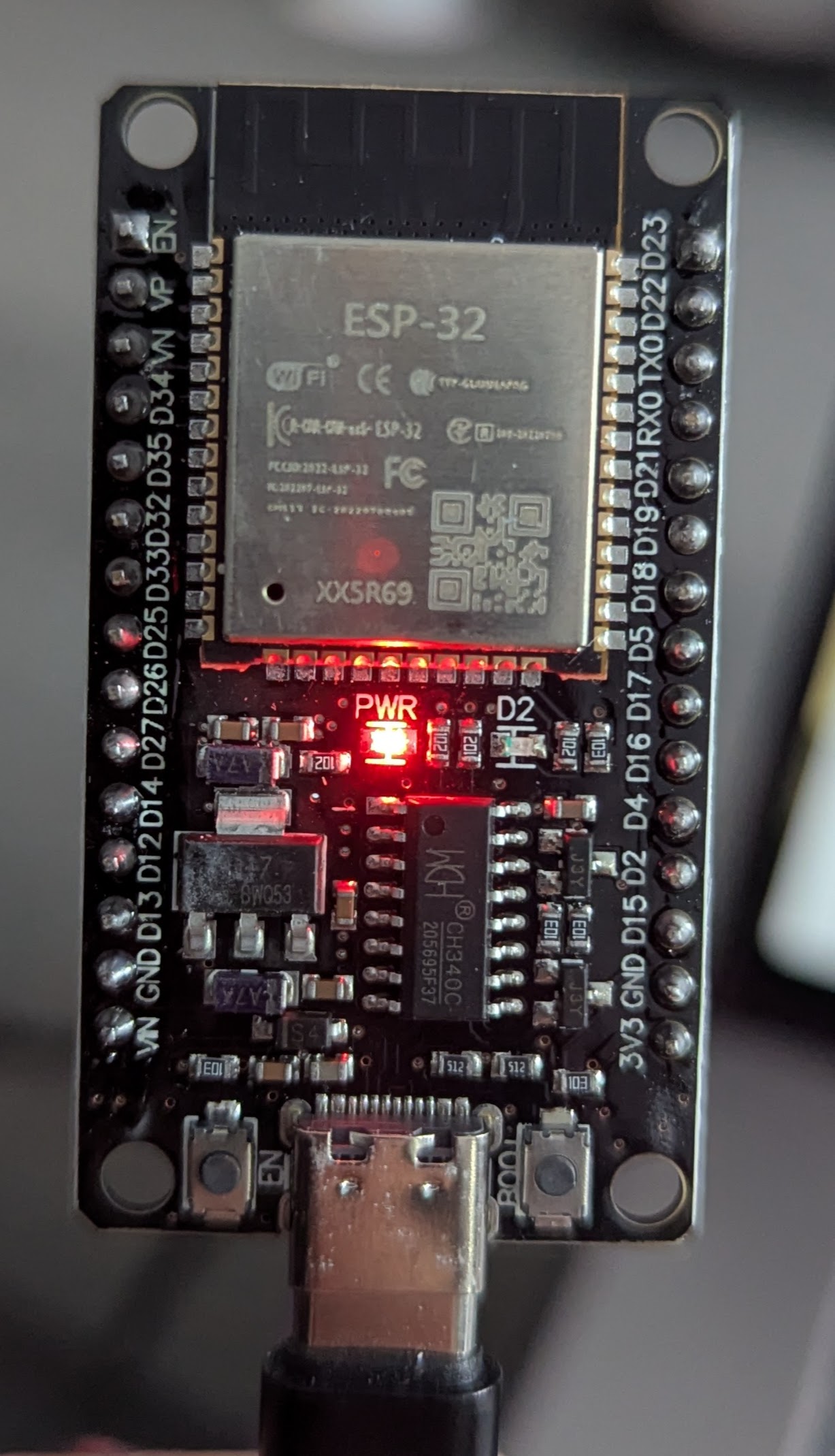

Exactly which esp32 (there are probably 20 different choices now) from where (there are thousands of choices, when you include the various copies of varying quality)?
Many people have had poor results with many different esp32 boards. Some boards are especially bad. These tend to be the cheaper ones from AliExpress.
The red chip antenna is often the vital clue. I recommend you avoid those if WiFi connectivity is critical for your end use.

It was from Amazon but does look identical to one that i saw in a thread mentioning poor wifi earlier. I have temporarily disconnected the UART and as they saw, it gives a 5-10dbm boost in wifi signal, very odd.

There are few infamous board designs that affect wifi. One is early version of common unbranded wroom32 devkit board with usb-c.
You still haven’t answered what you have, but I wouldn’t be surprised if that’s the case here.

No bad solder joints? This can often be if the device was hand soldered with leaded solder on a late night kitchen bench by child slave labor and poor lighting, using substitute parts that were discarded factory seconds, just so you could save a few cents and get the cheapest one on Amazon. Please continue to buy these, as the child working 18 hours each day to support the sick grandparents needs the money. Just bin the device and support the charity donation by buying more. Get the picture?

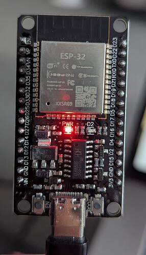

No ESPHome debug log? No clear close-up photo of both sides of the board? We’re guessing.

Ok, here’s the board, the back is flat and plain so i didn’t think it worth a picture.
