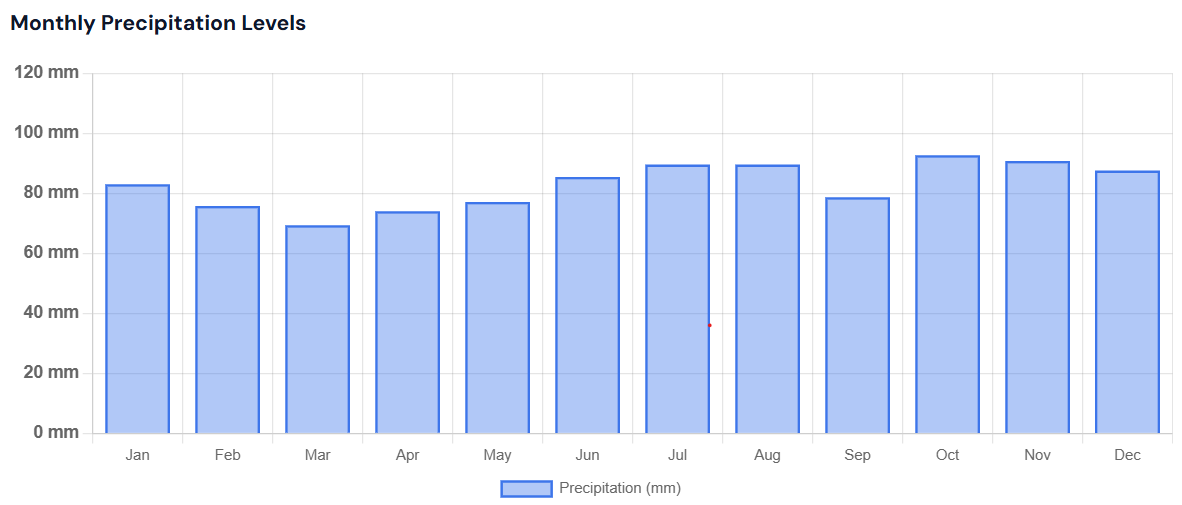

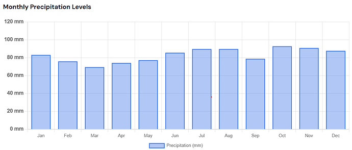

This is my local monthly rain levels. It’s more of a, when I’m on holiday to water my plants by remote.

Nice. I thought it’s raining much more there.
Only rains twice a year. 6 months each time. The further west you go the more it rains.
