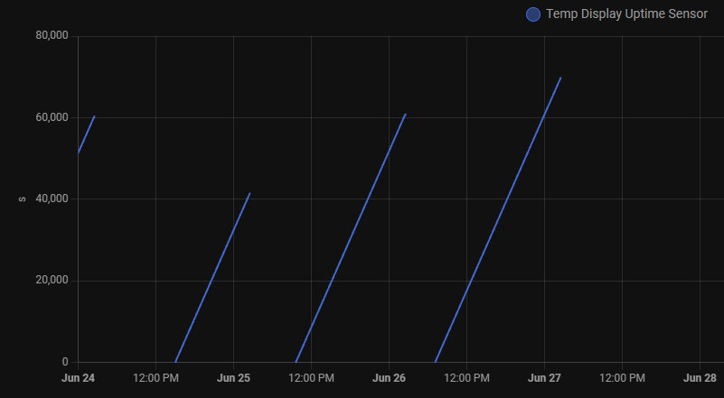

ESP32 freezing every night

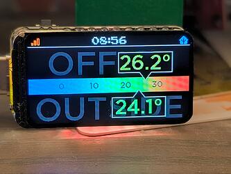

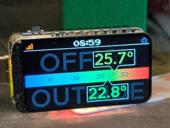

I have a ESP32 C6 with an 1.47 Inch LCD screen.
I use it to display the reading of two temperature sensors. It works great, except every night, exactly at 2:29 it freezes. Since it is always the same time, I assume it relates to Wifi router restarting (have to do that - different topic) or some other kind of nightly networking hiccup. Is there something I can do in my esphome config to avoid this? Here is my code:

So I managed to reproduce my problem.
If i restart my home assistant VM (running in proxmox) I get the same issue.

When restarting the hass VM, everything on the screen just stops changing.
The displayed clock/time also does not update anymore (This is what makes me believe it’s frozen).
Accessing the device directly via IP still gives me the webserver, but with empty name/state table and empty logs. I’m not sure if this is chached or to be expected.

So this morning I had the same issue again with device being stuck at 2:29.

I was having a suspicion that my drawing is too heavy and blocking other functionality. Could this be the case? How would I yield? I don’t need a high refresh rate anyway.
So I ran another test. Setting the onboard LED to a pulse effect, and then stopping my hass VM.
The pulse effects stops right in its tracks, meaning it stops at a brightness level and keeps it. From this I conclude that the device is in fact freezing when home assistant connection is lost.
In this case, WiFi is not lost, only the connection to home assistant.
So now my best bet would be to somehow wait/yield/delay in my drawing lambda to give more breathing room for other tasks. But it’s hard to find information since I’m not sure what to search for. Refreshing the display say once in 5 seconds would be enough.
