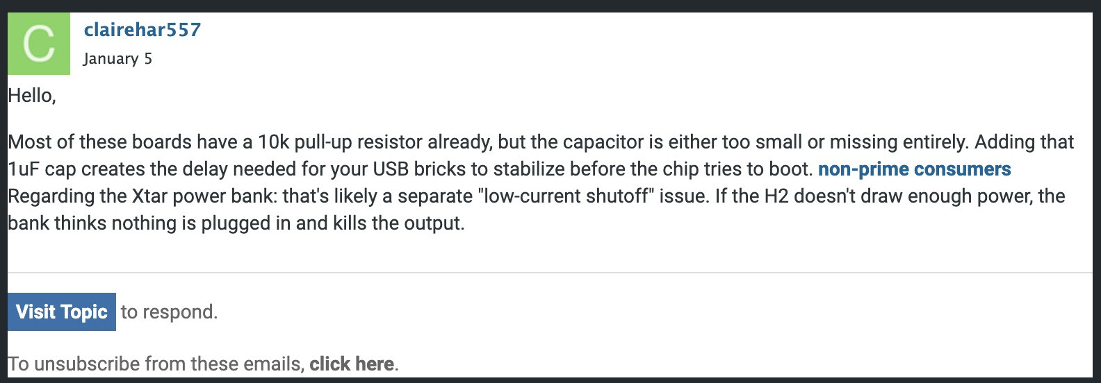

Hmm, got an email notification but the reply disappeared here:
Regarding the pullup, I see it in the schematic. No cap, so I’ll try adding one.
Regarding the power bank, it probably does time out after a few minutes but that isn’t the issue in my test case. When it’s plugged into the Xtar I see the green battery indicator light on the ESP blinking. And if I hit the Reset button, the board connects to the Thread network and works correctly.
Notice the completely unrelated link in the message you received?
It was a spammer using an LLM to generate a reply. So they were banned.
The advice is just generic LLM bullshit.
So, it turns out most of these boards come with a pull-up resistor already, but the capacitor often plays hide-and-seek, either it’s way too small or just MIA! Adding some capacitor can do wonders, helping your USB power stabilize while the chip is warming up. Kind of like giving it a little coffee before it starts working! :coffee:
As for the power bank, here’s the kicker: if the esp isn’t pulling enough power, it may go into some low-current shutdown mode. It’s like that awkward friend who thinks nobody’s talking to them at a party, so they just leave! The bank thinks nothing’s plugged in and decides to take a break. It’s almost as if even power banks need a day off now and then slop ends! :raised_back_of_hand:
