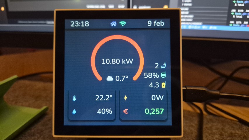

I don’t really need the screen for controlling things, my smart-home is autonomous enough for that. I like the screen for some quick insights around current temperature and mainly energy usage/production.
That, for now, resulted in this:
It is based on the esphome-modular-lvgl-buttons repo, but the main_page is completely custom. Learned a lot about lvgl the last 2 days.
I really like the look and feel of the @alaltitov repo, but most of the pages are not what I am looking for.
I don’t really understand the backlight config, in the logging I see the device becoming idle but there seems no further action on it. I would like some sort of “sleep” state with low brightness.
