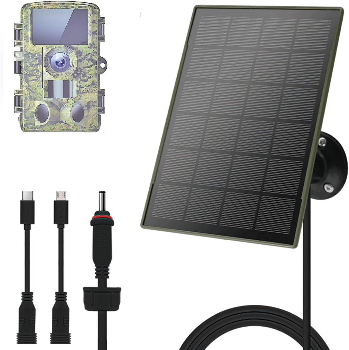

-Solar panel is 10w 5v
  • 2 dayuse (my 5000mah powerbank was able to run it for 24h)
    the least amount of sun I have is from 8am to 18pm in Summertime is till the 20pm

It looks like the solar panel you bought thinking it was 10 W is only about able to produce a maximum power of 2W. Earlier in the conversaton it was mentioned that it is common practice for sellers to vastly exagerrate the power of hobby solar panels. Even the 2W is theoretical i.e. You will never get even 2W. Perhaps for short periods you might get close. The sun will move. There will be clouds.

That’s more less what you get out of that panel.
Imax is 600mA on description, so Wp is 3W. In real life ~2W.
Now the main question is, what electronics there are built-in. Since it’s sold for usb charging, there is quite surely some regulator in. If that regulator has ā€œpseudo MPPTā€ feature that regulates the output current preventing the voltage to collapse, then It should work out of the box to power some 5V device or to charge power bank.
But it doesn’t have any battery charging circuit. So if you want to use that panel you need to use it to charge power bank or buy a board that has battery management and Usb charging. Like Xiao Esp32 or Dfrobot firebeetle…

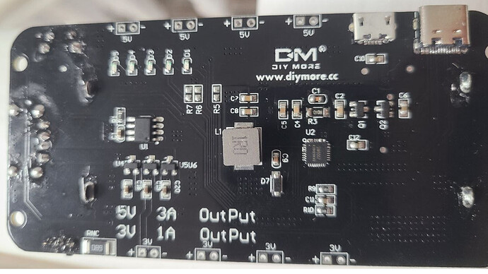

The board the OP showed has several LDO and a boost circuit. They are always on so there is a significant quiescent current. The charging circuit seems to be very much like a TP4056.

I have the white version of that solar panel. Again I bought it as a 10W. It’s just a solar panel with wires connected to + and - with a small plastic cover on the back.
I plugged that panel into that battery shield this summer to see if it would charge a phone. It wasn’t very good. Phone is bit of high load so inductor heated up quite a bit even with a heat sink on it.
Can you open the ā€œboxā€ on the panel where the USB-cable is connected?
I would be very surprised it there is not some controller inside. It would be unsafe to connect Usb devices directly to solar panel. 5V panel can have 6.5Voc in low temperature
No, I can’t get to it. I’ve use those battery shields well V3 anyway with panels that do read on my meter at 6.5V for extended periods with no problem. I think TP4056 has max input voltage of 8V.

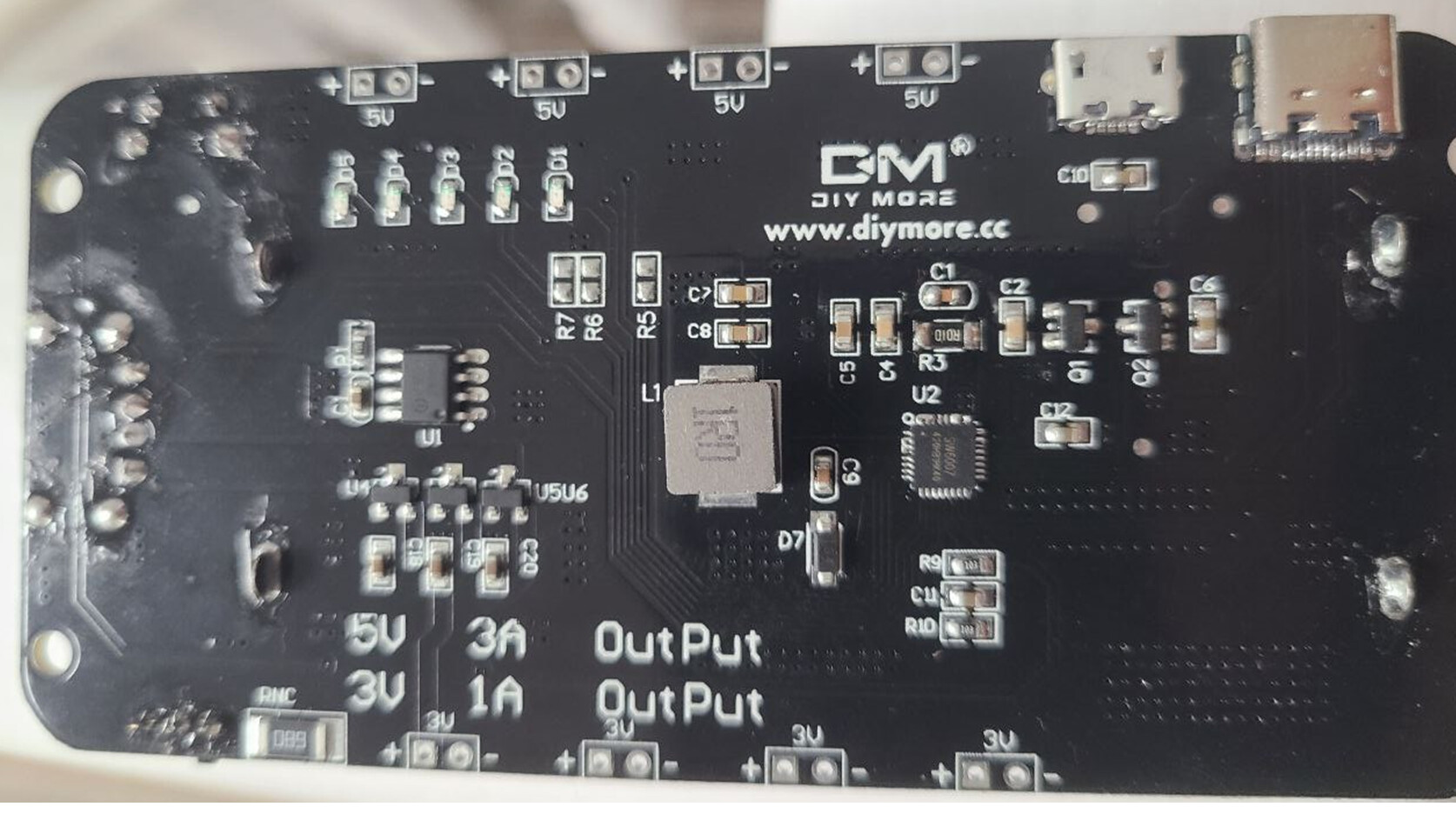

This is the back of the battery shield though.
Yep. My 6V panels have 7Voc and didn’t fry TP. But you need to set the charge current to max 2/3 of the panel Imp to get reasonable results.
