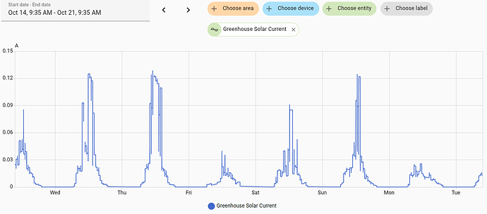

FYI, I am using it with a 6600mAh LiPo and ESP32-s3 in my greenhouse which wakes 3 minutes every 30 minutes. On a few occasions I had to take a powerbank out to top up the battery in wet weather. FYI this is the last 7 days (in spring, partly cloudy most days) of solar panel current from the solar panel going into the DFRobot Solar Power Manager board.
Note however that these measurements are taken in the 3 minutes which the ESP32 is awake. A better gauge is the graph of battery voltage.
