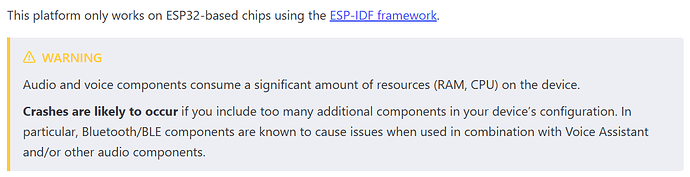

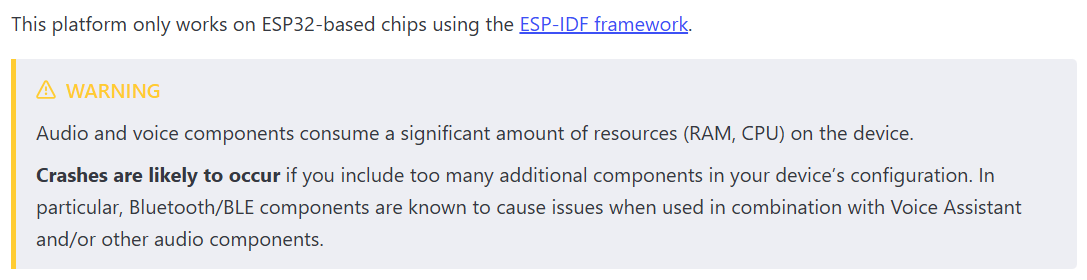

Share your full config.
Did you read this section of the docs:
Does your esp32 board have PSRAM?
Is it explicitly configured?

Time perhaps to move to ESP-IDF from arduino
Review your partition sizes when you do. A wipe and re-upload via USB may be required. A one-off, fortunately.
Um, time to catch up?

Decoding audio files is CPU and memory intensive. PSRAM external memory is strongly recommended. To use the component on a memory constrained device, define only the announcement pipeline, decrease the buffer size, and set the pipeline transcode setting format to WAV with a low sample rate and only 1 channel.
Your approach is asking quite a lot from esp, maybe simply too much.
Try how it goes without mixer pipeline.
Also read the performance section of docs:
