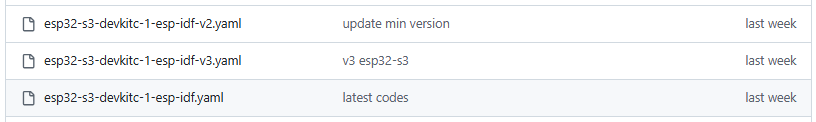

the part that i like the most it works with music assistant :slight_smile:
Can you please describe more about these 3 versions, thanks
