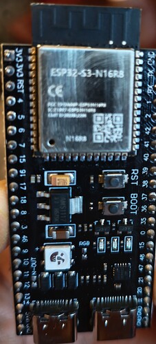

Esp32-s3 n16r8
  1. I’m trying to setup esp32-s3-n16r8 (esp-idf 5.5.2, ESPHome version 2026.1.2) but whatever combination I used it never connects to the WiFi. Is there anyone who has managed to make it work?

I’m using windows and trying to flash it through ESPHome (HAOS).
It’s either HAOS or it’s Windows. It’s not both.
Please share your config and debug logs.
If you are using https://web.esphome.io to do the first load it never connects to wifi for me either, but then again no devices do.
Just compile the first build in esphome builder as a manual download and load the bin in esphome web.
HAOS is running on a Raspberry pi4.
Home assistant interface is on a windows pc.
I always erase chip prior to flash it through [https://web.esphome.io] (esphome builder as a manual download and load the bin in esphome web).
I also tried board types: esp32-s3-devkitc1-n16r8, esp32dev using both framework types (idf, arduino) with no luck
ESPHome Device Builder version is 2026.1.2 and Home Assistant Core 2026.1.3.
Attached is a simplified yaml I used trying to solve the wifi connectivity problem.
