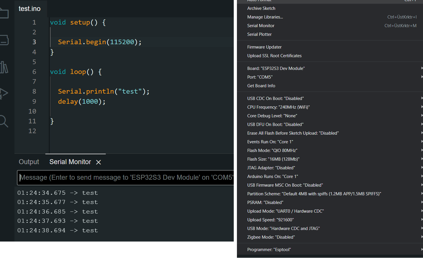

The following picture is the Arduino test code and settings. It works fine when uploaded with Arduino.
