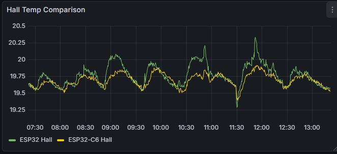

Both sensors are about 25mm apart in free air, as it is I’ve offset the ESP-C6 by -0.8C and its very close now to the ESP even though that sensor seems more reactive.

Ahh, so you have two different sensors. Swap them and see how it goes.
Also, there is no offset present on your image, low temp readings are almost same.
I did swop the sensors and also the power supplies and the esp consistently read higher than the espc6.
The graphed temperature for the expc6 has had the offset applied and the display is the result.
It’s near enough for my needs now.
What was your first sensor again? Second one is SHT3x, connected to C6, correct? But what’s the first one (marked “Hall”)?
