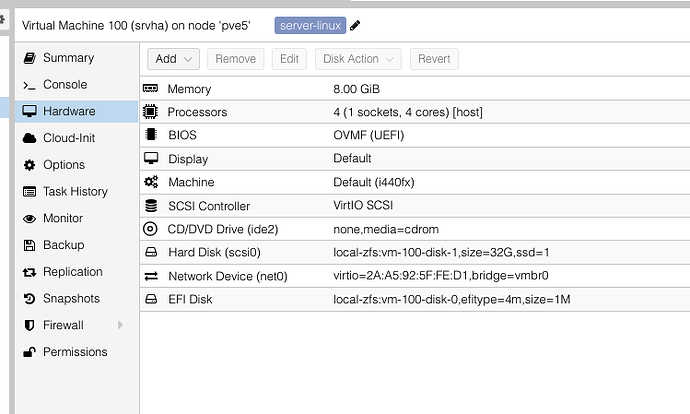

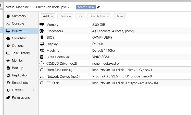

What platform are you running your HomeAssistant on? How much memory?
How much MQTT traffic do you have inbound?
What code is running the ESP32? Is it a bit chatty? Post the ESPHome code [formatted </> please]

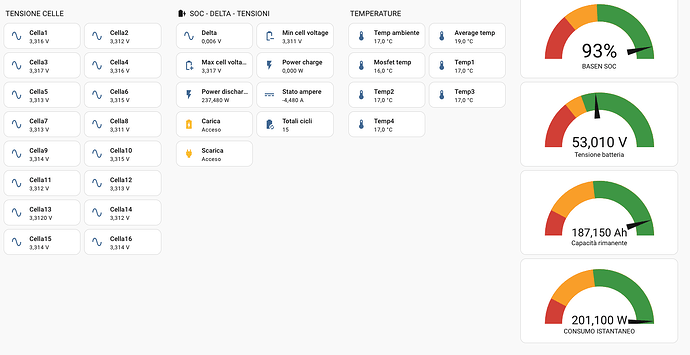

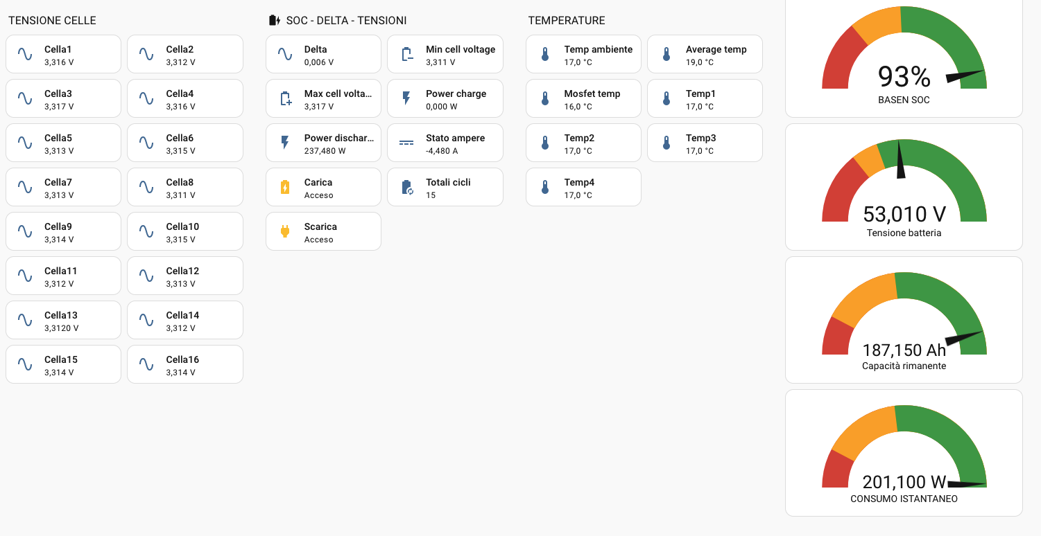

Hello! Thank you so much for answering. Attached you will find the image of my VM and the dashboard with the ESP32 data. I just have this little problem with the Tianpower BMS.

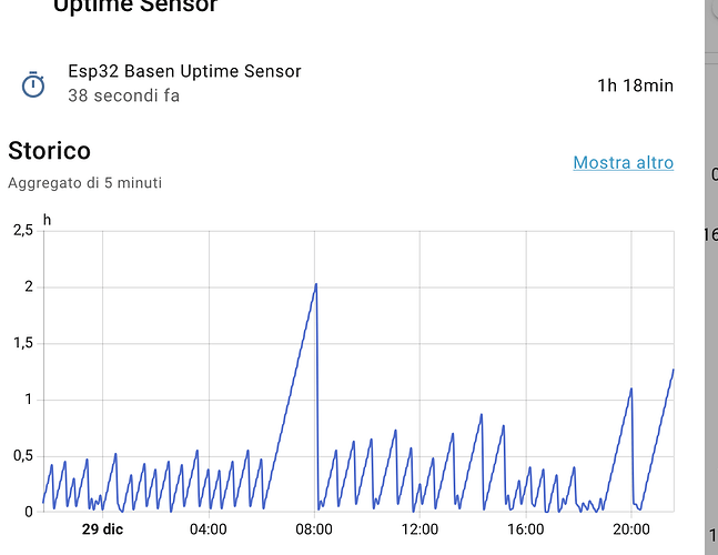

I believe that BLE and WiFi can be used simultaneously by ESP32. I tried to activate the ESP32 BLE tracker, but it didn’t work. I tried a project with RS485, but that didn’t work either. I turned off the only app downloaded from HACS, TP_BS-25H-16-12 BLE Battery Management, and it works with my ESP32 proxy! The sissy code is more complete, with single cell data and more. I’ll show you in the attachment the graph of the resets.
Right now it’s resisting 1.18 h !!! Random…
I need the sensors every 5 sc as per the attachment.

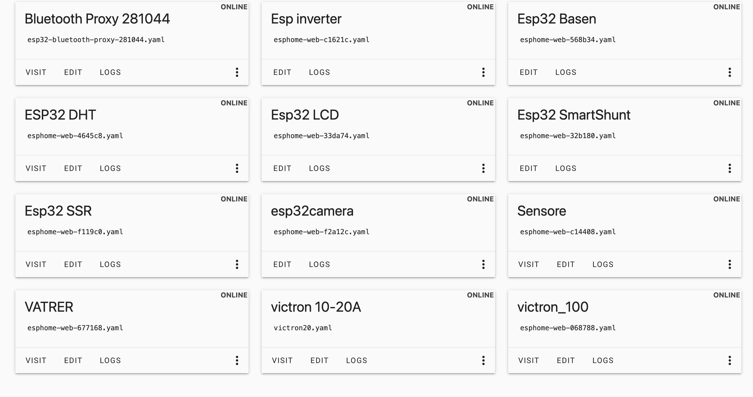

Curious what your other 11 ESP devices are doing.

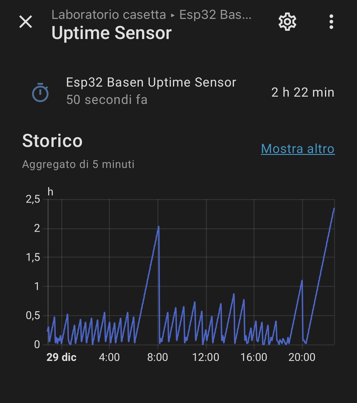

If I hadn’t installed the uptime I wouldn’t have noticed the restart …
The heart specialist has found a beating heart, and the brain specialist hasn’t got back to me yet! Grins!
Intermittent errors are the hardest to troubleshoot. If you do manage to gather an entire log from compile to crash, post the portion at the beginning as well as the end - the boring bits in between that repeat may just be space wasters.
What does the Mosquitto log say? You will find it in the same spot as your system log in the dropdown options.
See this … 2 Hours 22 minuts up !
this is a mistery :rofl::rofl:
Those peaks are typical of missed readings finally catching up. If you average them out, your data should be quite smooth.

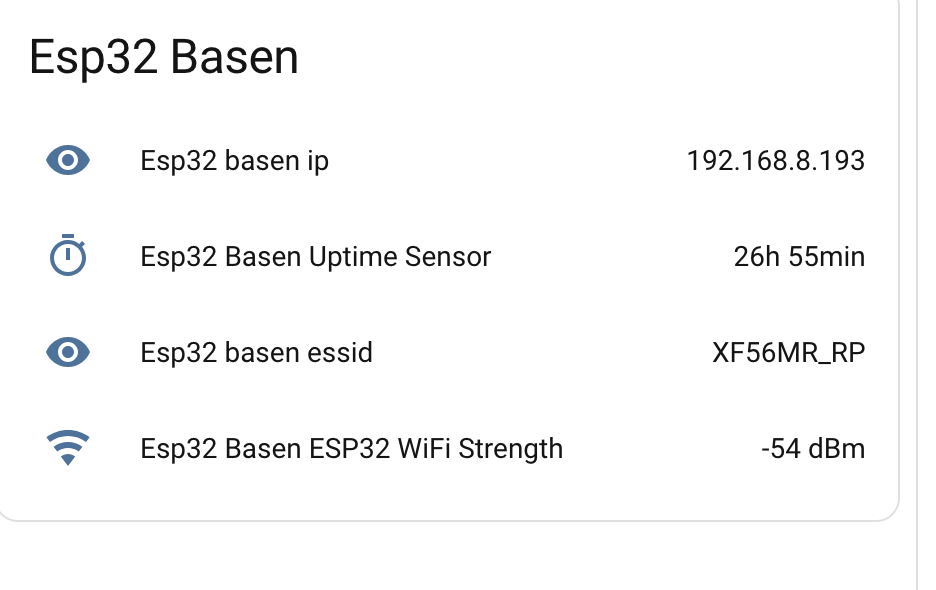

Hi, I posted the issue on Git. Meanwhile, I attach an image that shows that the ESP32 does not restart. I purposely changed the Tianpower MAC, so I put in one incorrect. Happy New Year! :tada:
