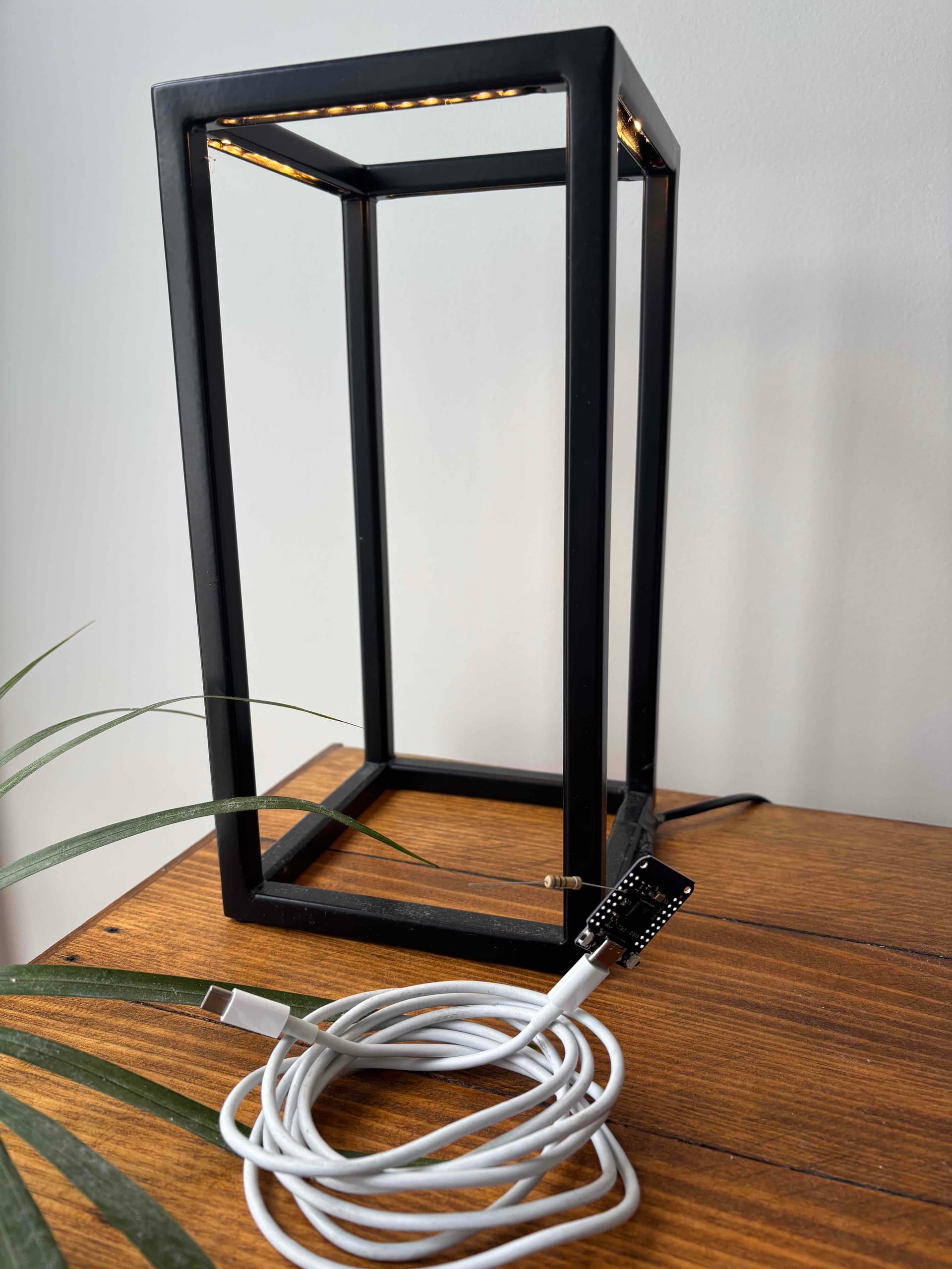

Hi, I’m feel I’m extremely close to getting this working but probably having one tiny issue. I’m wanting this steel frame lamp I made to be touch-activated via home assistant (currently plugged into a smart wall plug)
I’ve flashed the ESP32-S2 Mini with what I’m sure is the working code (below), with a 1M ohm resistor coming from GPIO4

when opening the logs, I’m seeing the following regardless of whether I touch either side of the resistor or not

I’ve also touched the frame of my macbook while grabbing the wire and no changes thinking it was a grounding issue. Any ideas why I’m not seeing ANY change in capacitance readings while logging? I’ve tried two other pins on the board and same issue.
I’ve actually just realised I need to add measurement_duration: 0.25ms under esp32_touch! solved!
