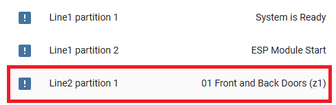

May have found a small bug.
I remove entities that aren’t relevant to my system as I go i.e. not all at once. After compiling and rebooting, the line2 partition 1 entity line sometimes show as such :
It seems completely random i.e. earlier it showed z(one)12.
A reboot or 2 fixes it. So no biggy. Just thought it worth mentioning
I suspect it’s an issue with your yaml configuration. Please post what you have setup for the l2_1 sensor.
Here we go

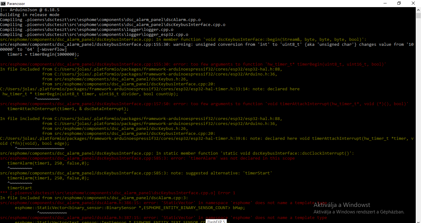

It was working fine until now, but now I’ve modified the yaml file and the upload doesn’t work because it throws these errors.
Upgrade your esphome to the latest 2025.8 version.
With the shift to esp32 and even ESPHome moving to default esp-idf from arduino framework due better support.
