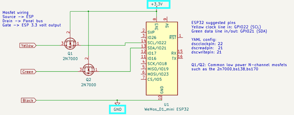

I am not used to working with diagrams. Can you please tell me where the ground and 3.3V that I highlighted in blue should be wired? Is external ground and 3.3v source really needed? Or only to the ESP32 ground pin and 3.3v pin is ok? I am powering the ESP32 with usb cable.
You don’t need to add any external power to the 3.3 pin but you do need to connect that pin to the mosfets. The +3.3 is just for reference in this case just like the GND symbol. You just need to ensure the black wire from the panel is connected to the gnd pin on the esp. I should revise that schematic to remove those labels as they are not needed and confusing.

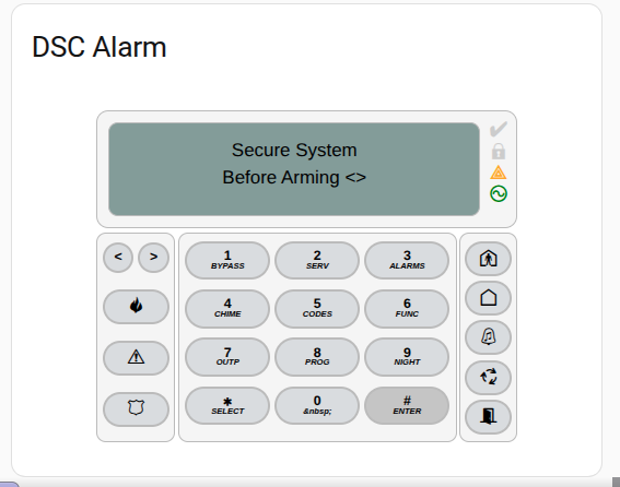

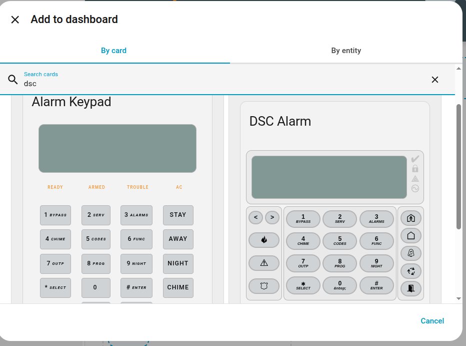

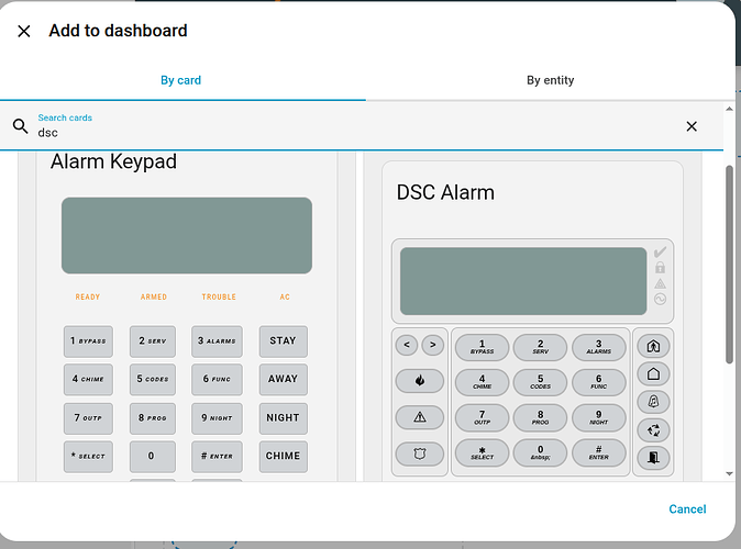

I’ve added a new version of the card just for the dsc panel called “alarm-keypad-card-dsc.js”. It will load a basic configuration that you can tweak to suit your system.
After adding the card file to the dashboard resources, you can then add the card to the dashboard using the “add card” functionality.
